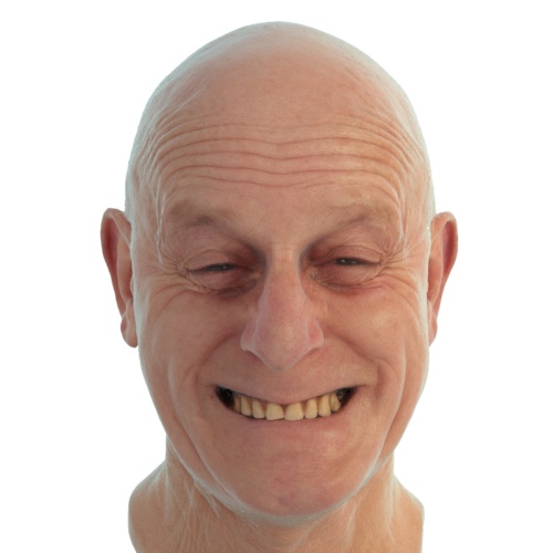

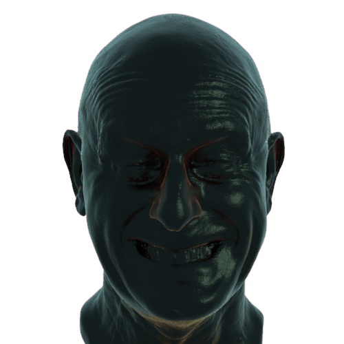

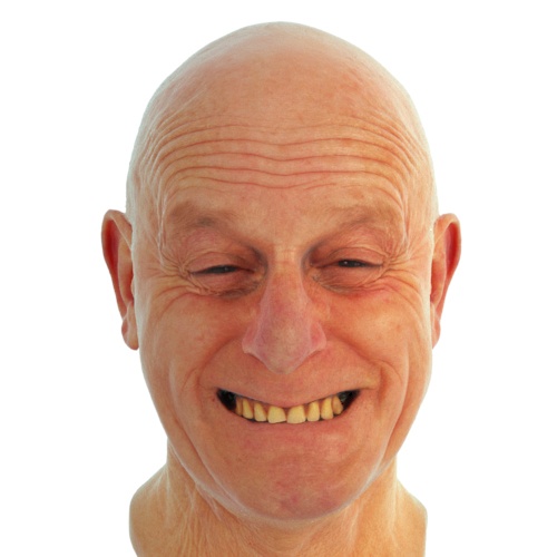

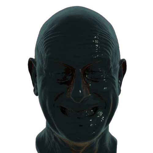

| Sheen Layer | Specular | Shallow Scatter | Mid Scatter | Deep Scatter |
As you can see, the shader is broken up into different SSS layers ('Shallow Scatter', 'Mid Scatter' and 'Deep Scatter'), each one with its own scattering radius, color, and weighting factor. There are also two separate specular/reflection layers.
