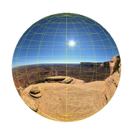

Format
How the environment/image will be interpreted. The type of map connected can be set to mirrored_ball, angular or lat-long.

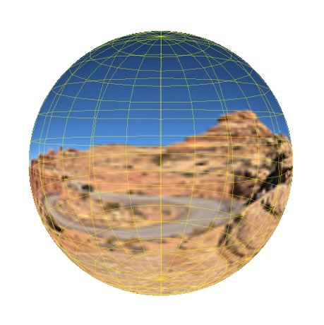

Sky Radius
The size of the sky
Facing
The direction that the HDR image faces in the viewport. Choose between front, back or both.
| Facing: Front | Facing: Back |

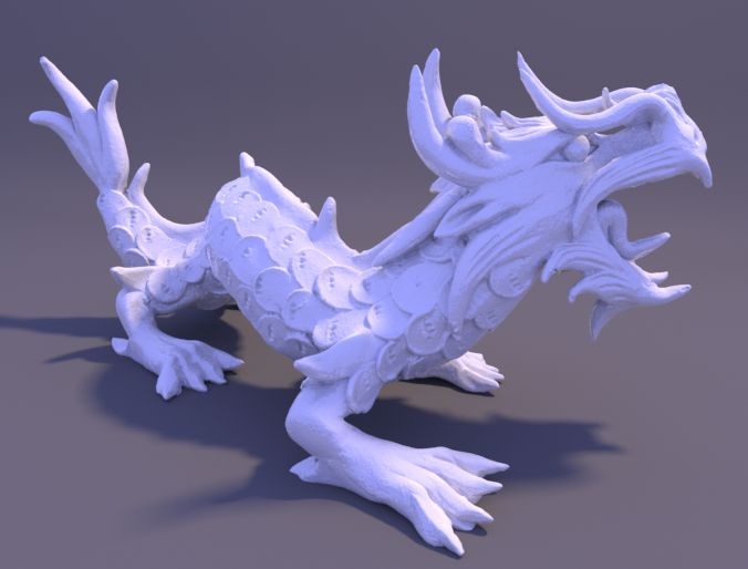

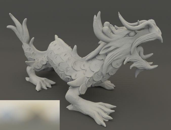

Below is a version of the dragon with the sky shader's color set to blue.
Dragon model lit with sky shader set to a flat blue color.

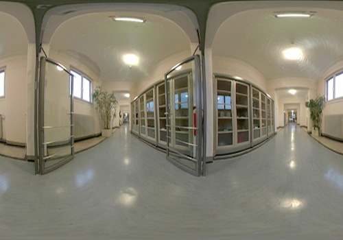

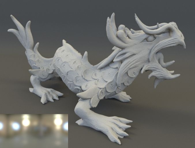

Note that it's important to set the proper mapping format in the sky shader. We'll use the following HDR image in "lat-long" format:

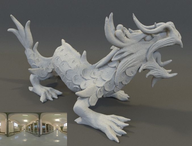

Dragon model lit with sky shader using a high-contrast HDR image
Even though this image is using the exact same GI sampling setting as the previous one, you can see that it has a lot more noise. This is because the environment map has a lot of high contrast areas with bright spots (windows, ceiling lights) and dark shadows, which is difficult to sample.

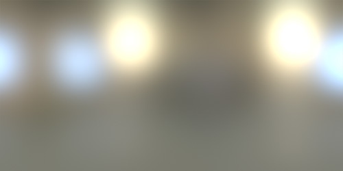

Below are the images used for the different ray types, using a gaussian blur in PhotoShop.
| HDRI used for Reflection/Refraction rays (3000x1500 pixels). | Diffuse/GI rays (200x100 pixels). | Glossy rays (800x400 pixels). |
Depending on the dynamic range of the HDRI you may need to blur more or less to achieve optimal results. Also, how blurry the map used for glossy rays should depend on the material; for very sharp materials (almost mirror-like) you don't need as much blurring, but if your glossy reflections are very soft you should use a bigger blur.

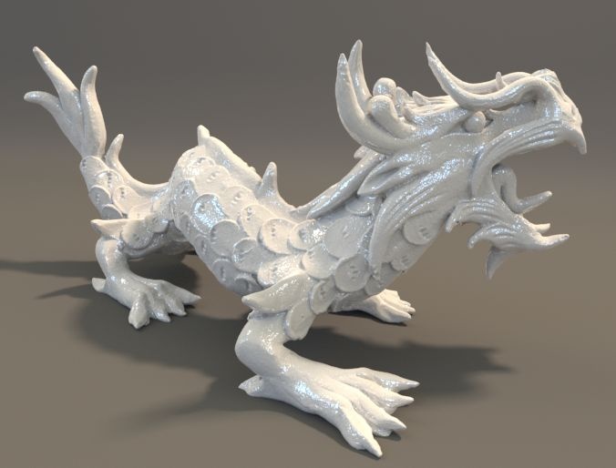

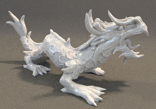

Here's the resulting image from this setup:
Dragon model lit with sky shader using separate HDRIs for each ray type.
Note how with this setup the noise is now gone and the illumination is very similar to the version using a single high-res map for all ray types.

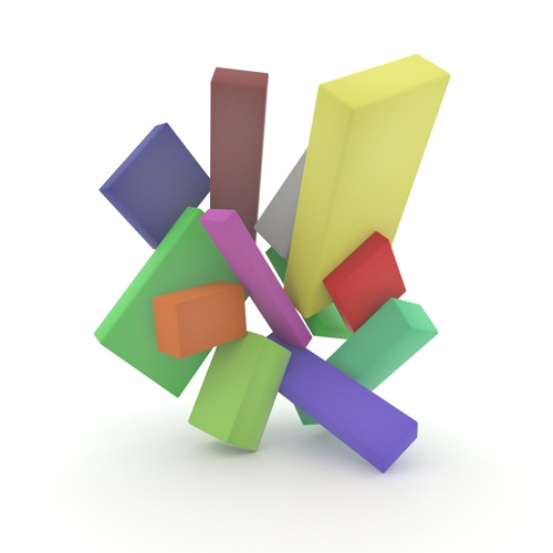

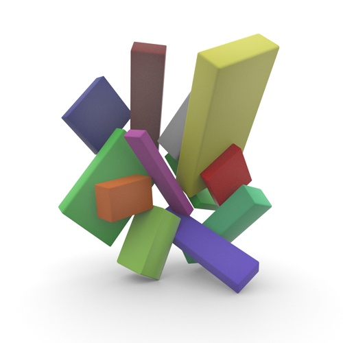

The scene below is lit solely using a sky shader with the color set to white. The number of diffuse rays has been increased to 4 to reduce noise from the sky around the floor. You can clearly see the effect increasing the diffuse_ray_depth has on the amount of bounced illumination in the scene.
| diffuse_ray_depth: 1 | diffuse_ray_depth: 3 |
