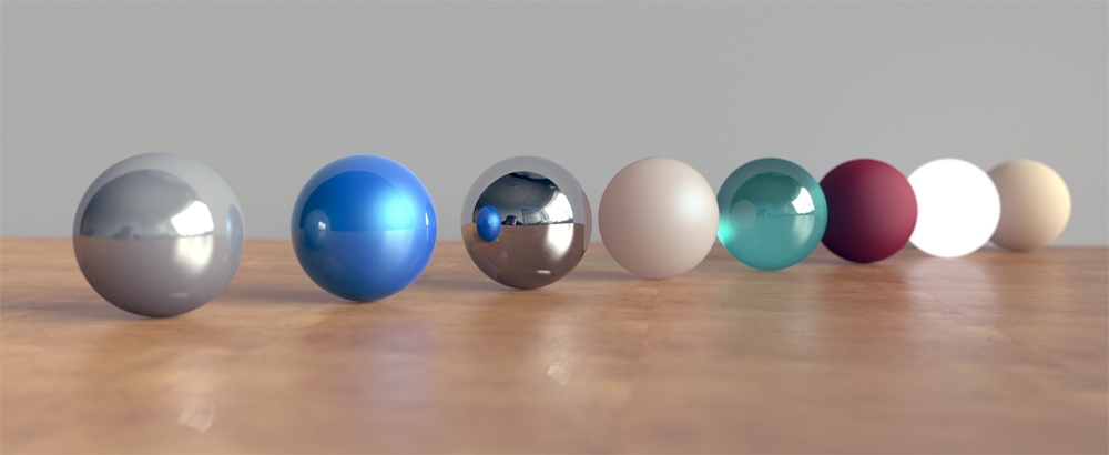

The example below shows the difference when rendering using physically correct values (left) compared to a shader that uses physically incorrect values above 1 (right image. The light leaving the surface is brighter than the light which originally fell upon it). No material bounces back light at 100%, except for a perfect spotless mirror.
| Diffuse Weight: 0.7, Specular Weight: 0.3 (totalling 1 is correct) | Diffuse Weight: 0.7, Specular Weight: 1 (totals above 1. Specular highlight appears blown out) |

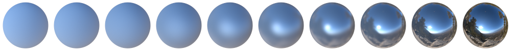

A Standard shader with a high Diffuse Roughness will reflect dimmer and broader highlights, while smoother and more reflective materials will reflect brighter and tighter highlights.
Diffuse and rough (left) to reflective and glossy (right).
