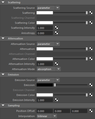

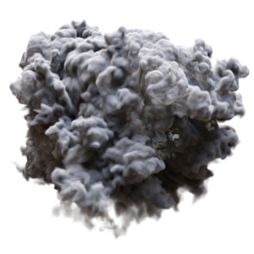

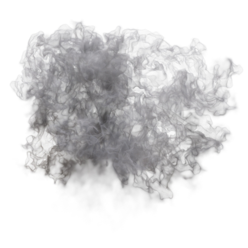

Scattering
Scattering Source
Scattering Parameter
This is the rate at which light is scattered (or reflected) at a given point. The greater the rate of scattering, the shorter the average distance a ray of light will travel through a volume before being bounced off of its course. Usually, the volume density is connected to this parameter.
| 0.1 | 0.25 | 0.5 |
Scattering Channel
When not empty, this channel will be used to sample the scattering values for the volume instead of the Scattering parameter.

Scattering Color
A color to tint (multiply to) the scattering.

Scattering Intensity
A scale factor to adjust the scattering.

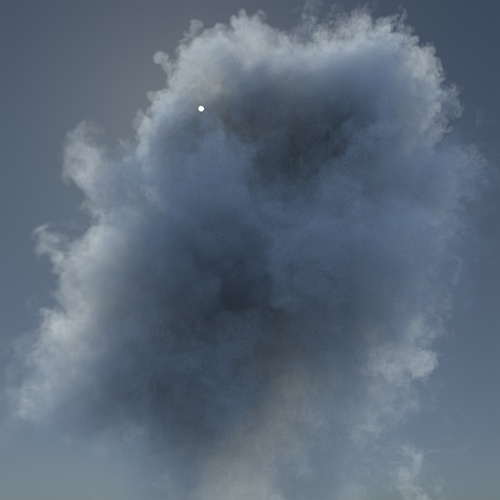

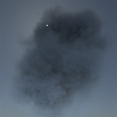

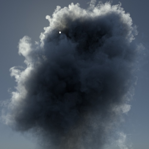

Anisotropy
Henyey-Greenstein Anisotropy coefficient between -1 (full back-scatter) and 1 (full forward-scatter). Default is 0 for an isotropic medium.
Note that values very close to 1.0 (above 0.95) or -1.0 (below -0.95) will produce scattering that is so directional that it will not be very visible from most angles, so such values are not recommended.
| -0.75 | 0 | 0.5 |

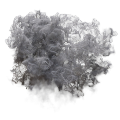

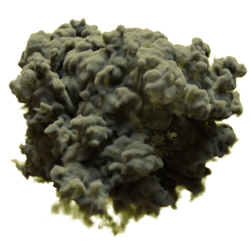

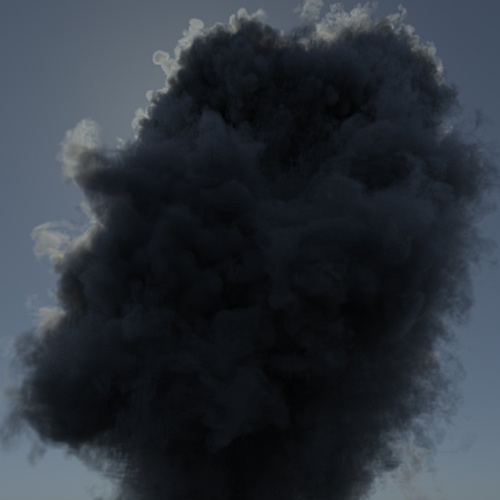

Attenuation
Attenuation Source
Attenuation Parameter
The rate at which the intensity of a ray traversing a volume is lost.
| 0 | 0.5 | 1 |

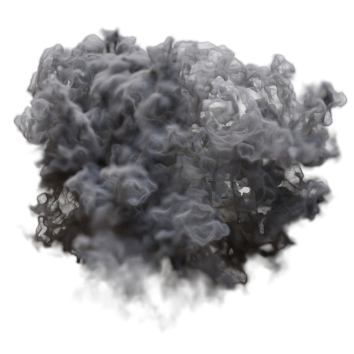

Attenuation Color
A color to tint (multiply to) the attenuation.
| Red | Green | Blue |
Attenuation Intensity
| 0 | 1 | 5 |

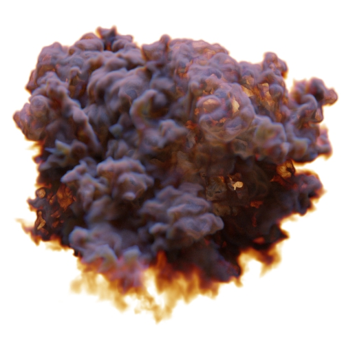

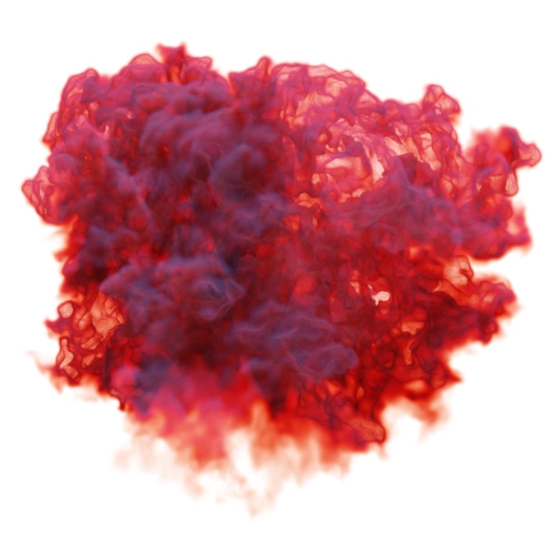

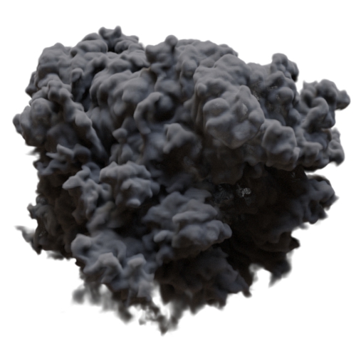

Absorption
The intensity is lost due to absorption events only. The volume is guaranteed to conserve energy so it should work robustly no matter the lighting and GI settings, but can appear overly dark.
Extinction
The intensity is lost due to either scattering or absorption events. It is possible to obtain non-physically real scattering effects in the volume. More light will be scattered than what is actually attenuated by the volume. This is done by setting the attenuation coefficient to a value that is lower than the scattering coefficient. This can be useful to have more control over the brightness of a volume, but causes energy conservation issues which can become troublesome depending on the lighting setup and GI settings.
| Absorption | Extinction |

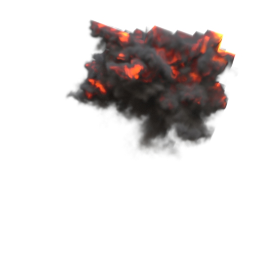

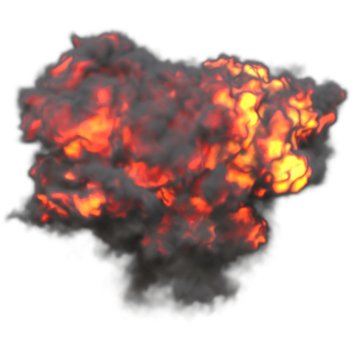

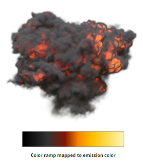

Emission
Emission Source
Ensure that the emission attribute is driven by a VDB grid. If it is a fixed parameter value you may get artifacts.
Emission Parameter
Emission is the rate at which a volume emits light at a given point. The light emitted by a volume is visible to GI. It will also be affected by any out-scattering or absorption effects in the volume. A heat (flames) grid would be connected to this parameter.
Volumes can only receive indirect lighting from other emissive volumes when the Volume Ray Depth is above 0.
Emission Channel
When not empty, this channel will be used to sample the emission values for the volume instead of the Emission parameter. The sampling tab has additional parameters to control how data is sampled from volume channels.
Emission Color
A color to tint (multiply to) the emission.
Emission Intensity
A scale factor to adjust the emission.
| 1 | 5 | 20 |

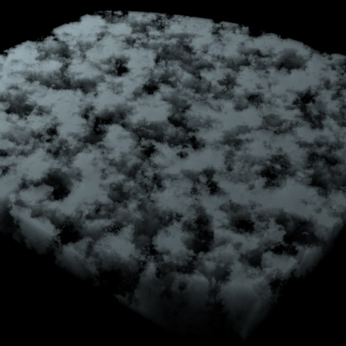

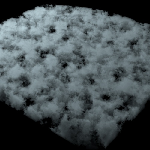

Sampling

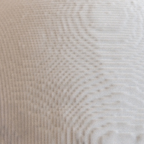

Position Offset
An object space offset to apply to the volume sampling position when using named channels to fetch the volume data. This is useful to displace the volume data.
You will need to connect a noise texture to the position offset to see any result.
| X: 0 | X: 50 | X: 100 |

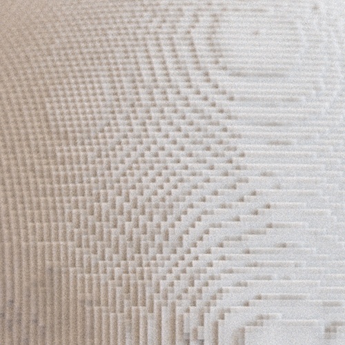

Interpolation
The voxel interpolation to use when sampling the volume data using named channels.
| Closest | Trilinear | Tricubic |
