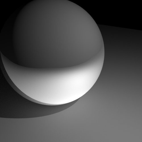

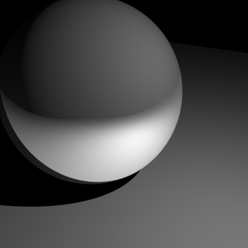

Enable Glossy Caustics
This switch in the Standard shader specifies whether Indirect Diffuse rays will compute Direct Specular and Indirect Specular light components.
| Disabled | Enabled | Increasing the Specular Roughness reduces the noise |

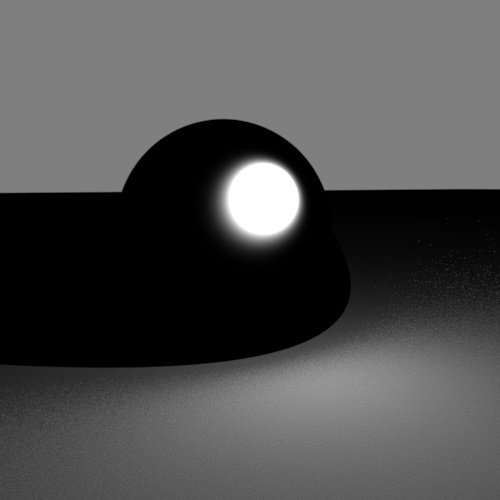

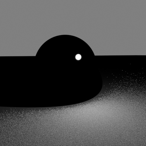

Enable Reflective Caustics
This switch in the standard shader specifies whether Indirect Diffuse rays will compute the mirror reflection component.

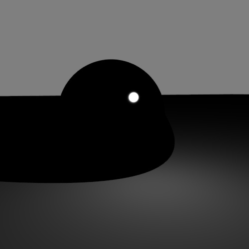

Enable Refractive Caustics
This switch in the standard shader specifies whether Indirect Diffuse rays will compute the refraction component.

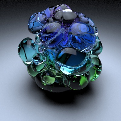

Standard shader with 'Enable Refractive Caustics' enabled
