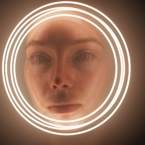

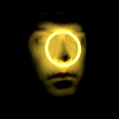

Torus shapes converted to mesh light. Model (left) kindly provided by Lee Perry Smith.

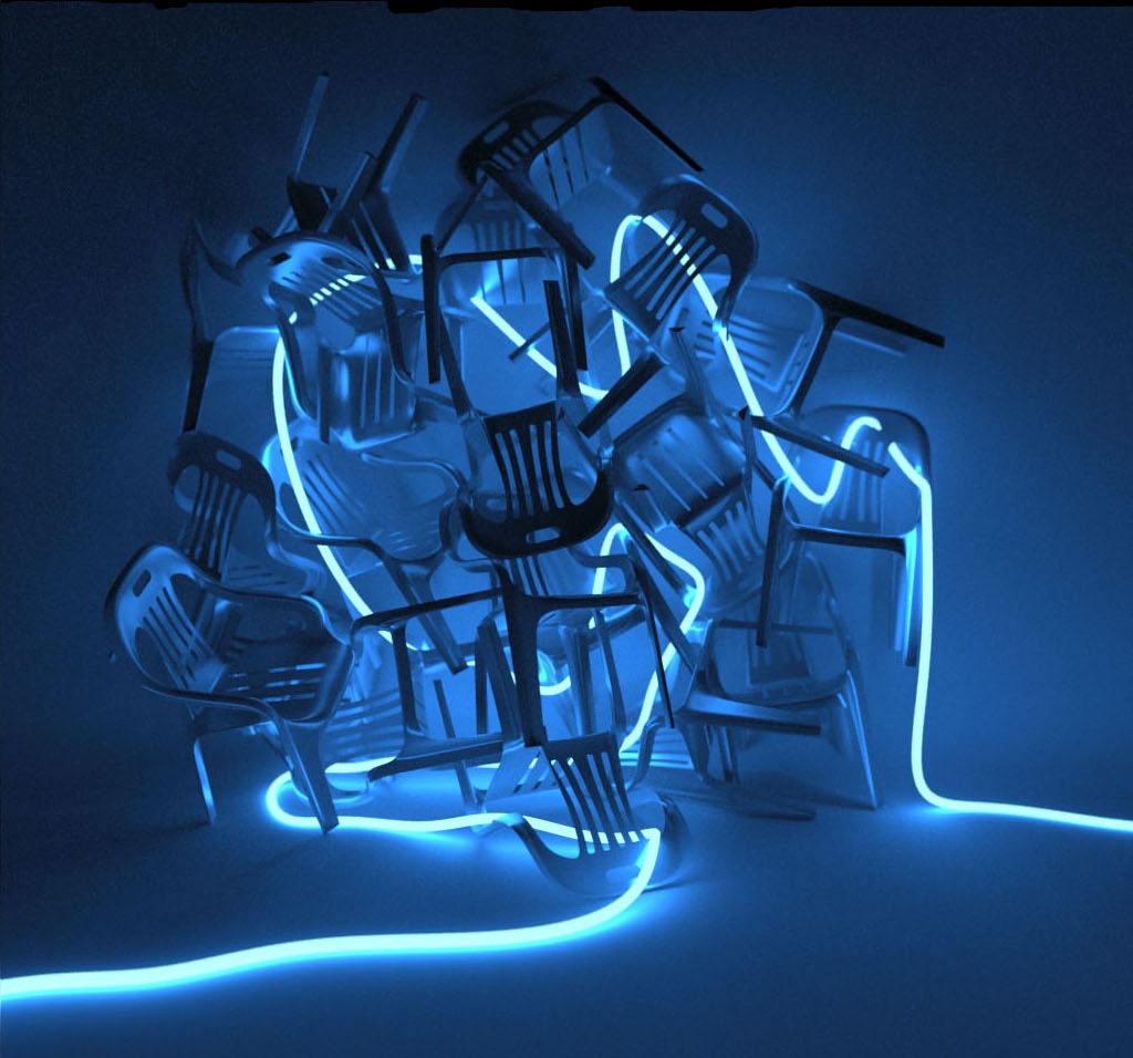

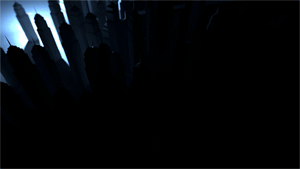

In situations where conventional light shapes will not suffice, mesh lights are more suitable. The mesh light can be used to create interesting lighting effects that would not be possible any other way. For example, effects such as neon lighting or a car light motion trail effect can be achieved more easily with mesh lights.
Geometry converted to mesh light

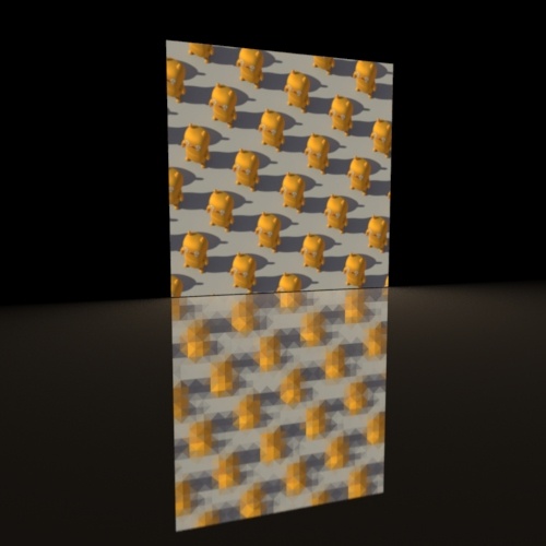

You may need to increase the number of Subdivision Iterations for the mesh light if the color texture is clearly visible in specular reflections. For example, this may be evident in a scene where a TV screen is reflected in a glass window.
| 4 | 5 | 6 |

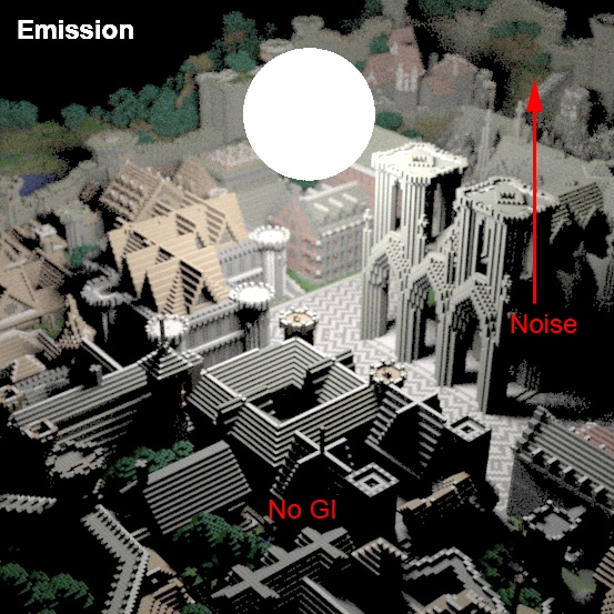

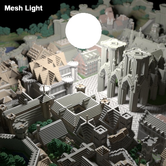

Below is another comparison test between a mesh light (left image) and a sphere with a highly emissive Standard Surface shader assigned to it (right image). As you can see in the mesh light image, light is bounced around the scene, whereas there is no bounced light in the emissive sphere render. This is because the rays from the Mesh Light work in conjunction with the Diffuse rays, whereas only the primary rays are considered when using Emission only. Even with 6 Diffuse samples, the render using Emission only contains far more noise.
| 4 mesh light samples - clean render | 6 diffuse samples - noisy with no bounced light |
In the example below, Diffuse samples have been increased to ten to get a clean result using only emission in the scene. With a Mesh Light, the scene only requires three Diffuse Samples.
