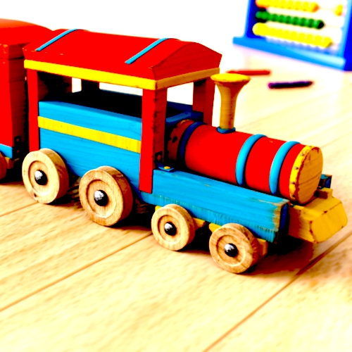

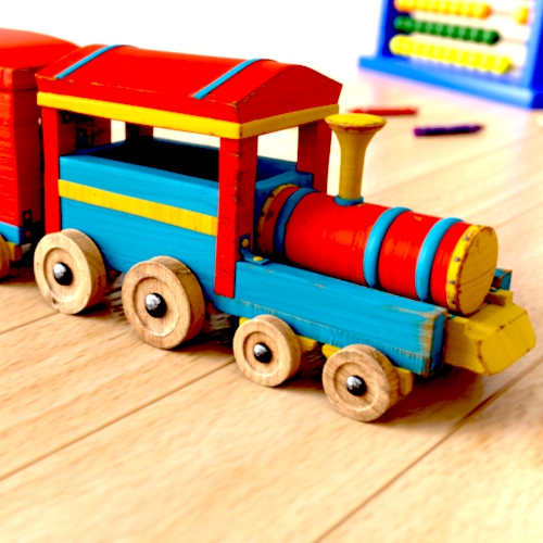

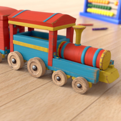

Contrast
Scales values around the Contrast Pivot.
| 0.1 | 0.2 | 0.3 |
