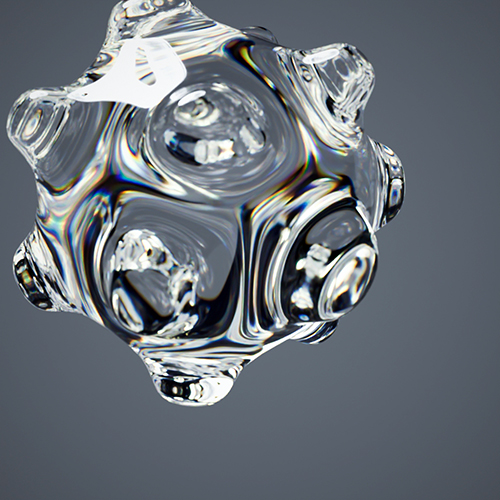

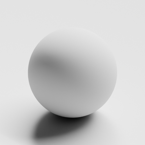

Caustics

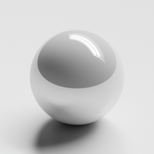

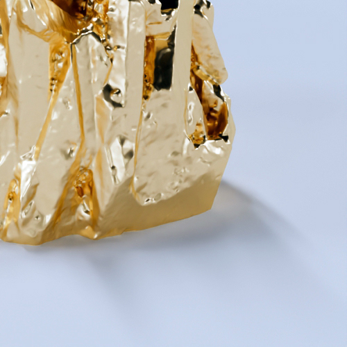

This switch in the OpenPBR Surface shader specifies whether specular or transmission bounces behind diffuse bounces are enabled or not. As caustics can be noisy, these are disabled by default.
To control noise from Caustics, the global Indirect Specular Blur setting may be increased, which blurs out Caustics to reduce noise at the cost of accuracy.
Arnold will require a high number of Diffuse Samples to achieve a clean image when using caustics. Care should be taken when enabling this feature.
| Caustics: disabled (default) | Caustics: enabled (reflective caustics) |

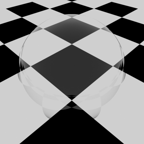

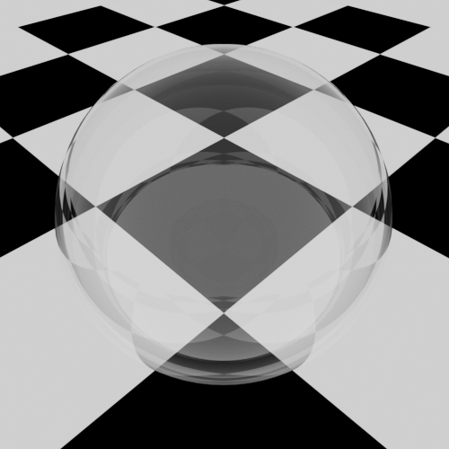

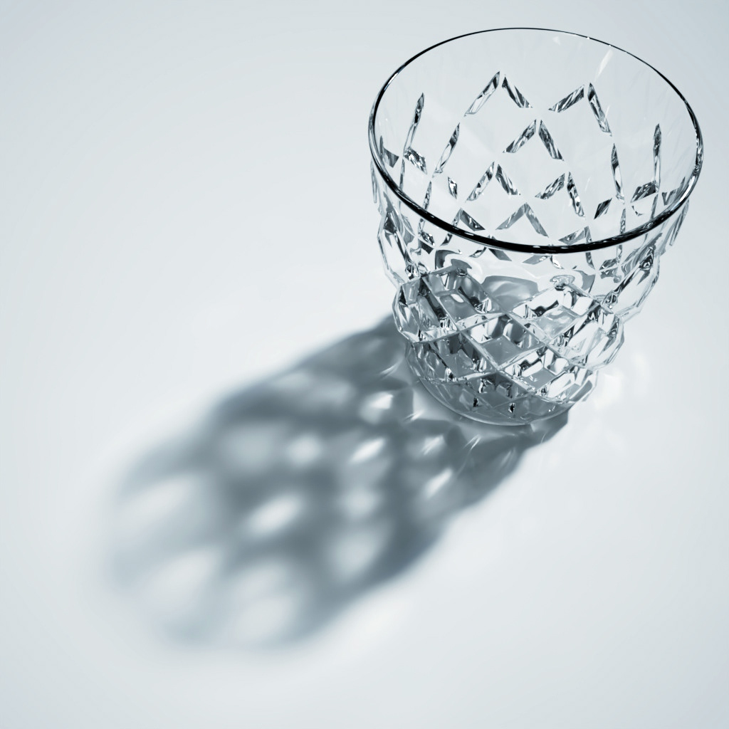

| Caustics: disabled (default) | Caustics: enabled (refractive caustics) |

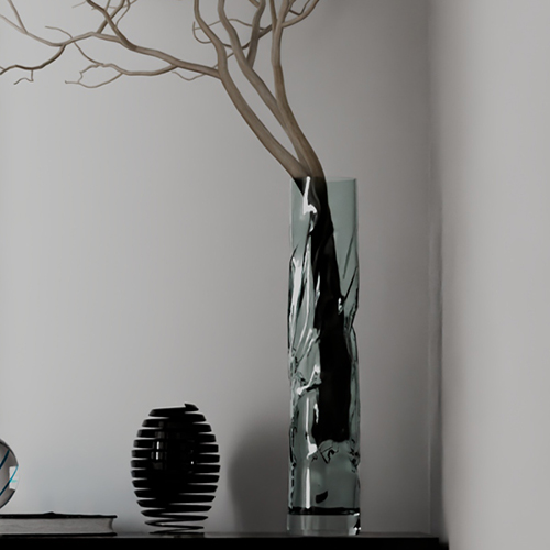

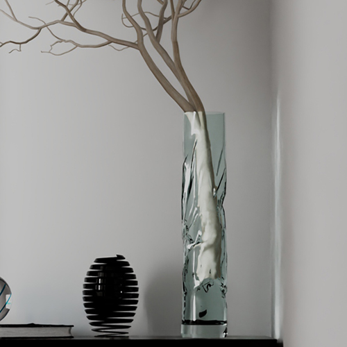

Notice that the areas in the scenes below are darker inside the glass. This is because the illumination inside the glass is essentially all caustics. Enabling Caustics for the glass shader fixes this issue.

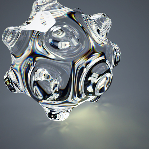

| Without Caustics (default) | With Caustics |
| Caustics: disabled (default) | Caustics: enabled (interior is brighter) |

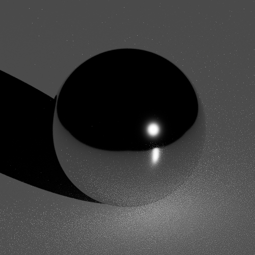

You may experience fireflies when using high Specular Weight, and low Specular Roughness with Caustics enabled. To reduce this type of noise, increase the Specular Roughness of the shader or Indirect Specular Blur globally.
| Disabled (default) | Enabled | Increasing the Specular Roughness reduces the noise |

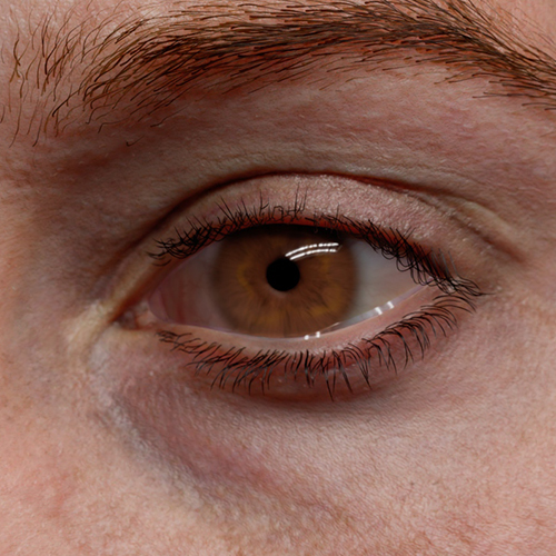

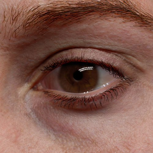

Enabling Caustics can add more believability when rendering eyes (Caustics enabled for outer cornea shader).
| Without Caustics | With Caustics |

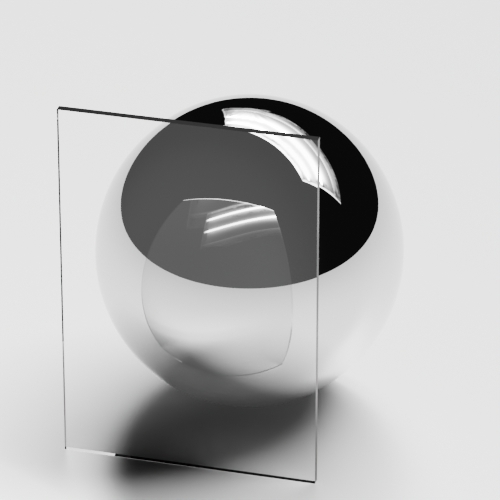

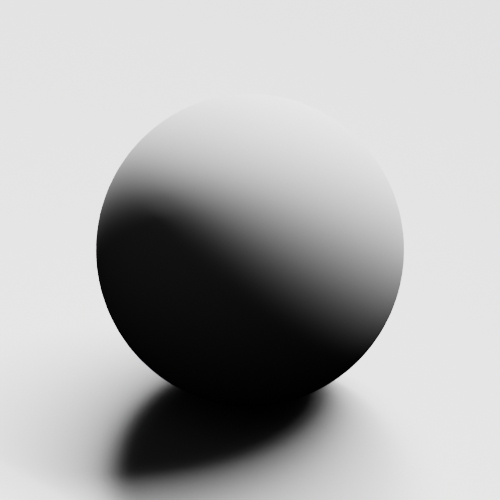

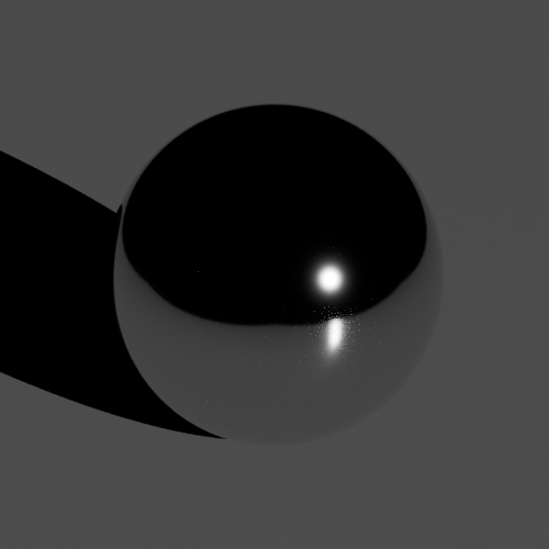

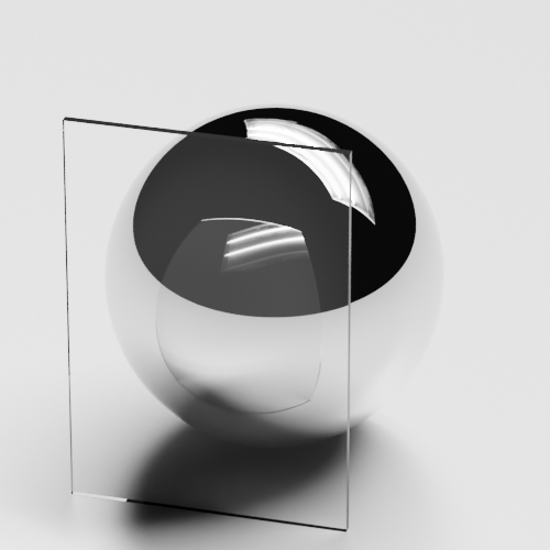

Internal Reflections
Unchecking internal reflections will disable indirect specular and mirror perfect reflection computations when ray refraction depth is bigger than zero (when there has been at least one refraction ray traced in the current ray tree).
| Enabled (default) | Disabled |
In the right image below, the sphere appears black because Internal Reflections is disabled in the OpenPBR Surface shader assigned to the sphere.

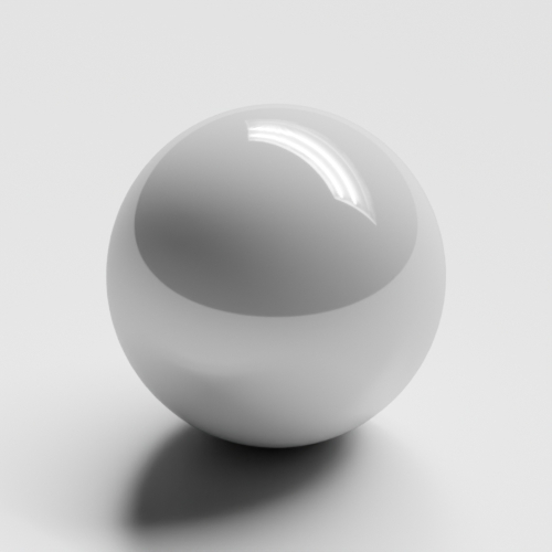

Exit to Background
This will cause the OpenPBR Surface shader to trace a ray against the background/environment when the maximum GI reflection/refraction depth is met and return the color that is visible in the background/environment in that direction. When the option is disabled, the path is terminated instead and returns black when the maximum depth is reached.

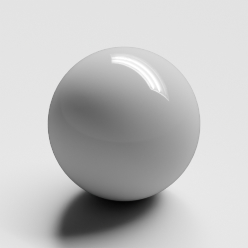

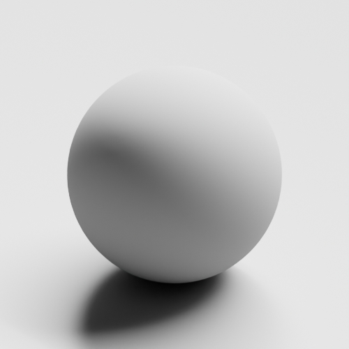

Indirect Diffuse
The amount of diffuse light received from indirect sources only.
| 0 | 0.5 | 1 (default) |
