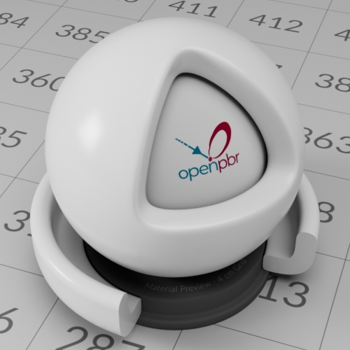

Enable or disable the matte effect. Disabling Enable Matte returns to normal shading.

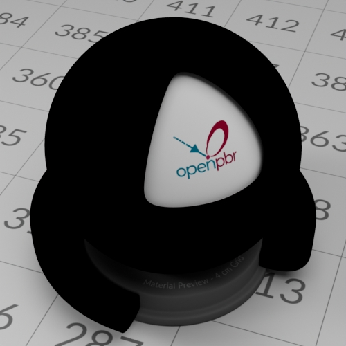

| Enable Matte: Disabled | Enable Matte: Enabled (default Matte Color: black) |

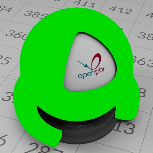

Matte Color
Changes the color of the matte.
| Red | Green | Blue |

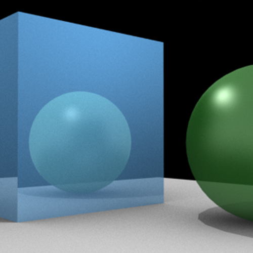

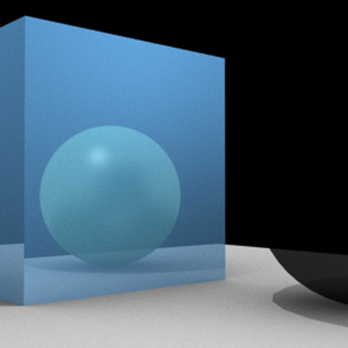

In this example, the matte property is applied to the green sphere, which is semi-opaque and reflected by the cube. These are the starting RGB and the alpha values, with the matte disabled.

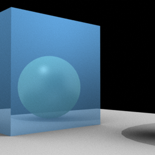

This is the matte with the default values. Note that the sphere looks the same as above when reflected.
Matte disabled. Note that the opacity and alpha are taken from the spheres shader.

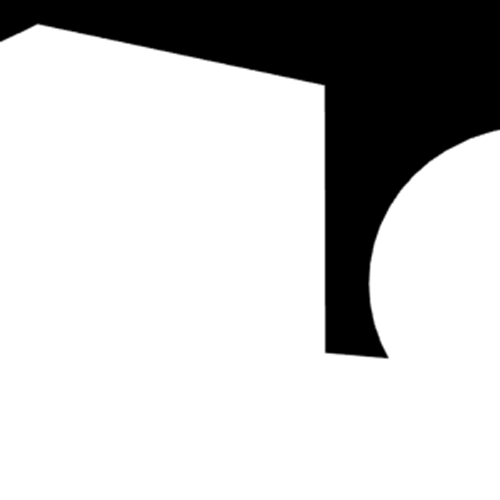

Overriding opacity, set to 0. The sphere is now invisible to eye rays, but still visible in the reflections and shadows.
