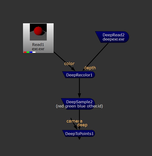

- First, change the output format to deepEXR. Render the scene and open it in Nuke using a DeepRead node.
- In Nuke, create a DeepRecolor node. Connect the depth input of the DeepRecolor node to the deep EXR. Next, connect the color input of the DeepRecolor node with the 2D EXR render.
- Connect a DeepSample node to the DeepRead node. The DeepSample node will give you a list of samples for each pixel (see images below).

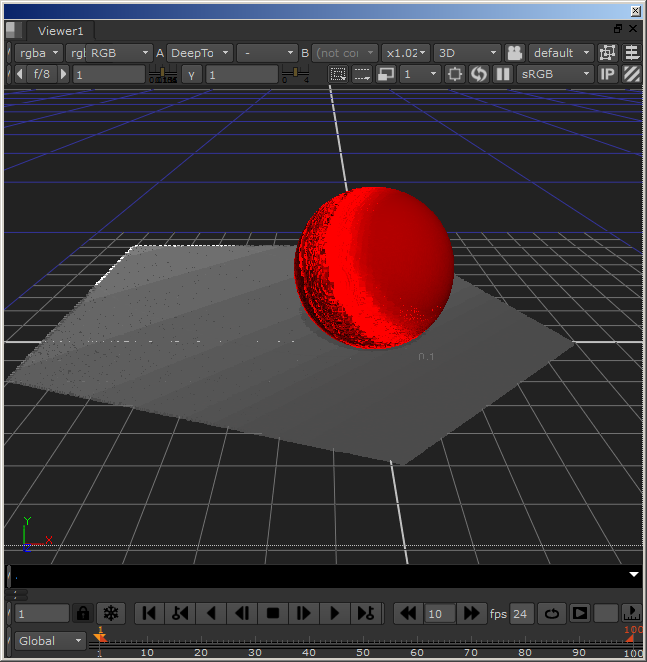

- Create a DeepToPoints node and connect deep to the Deep Sample node.

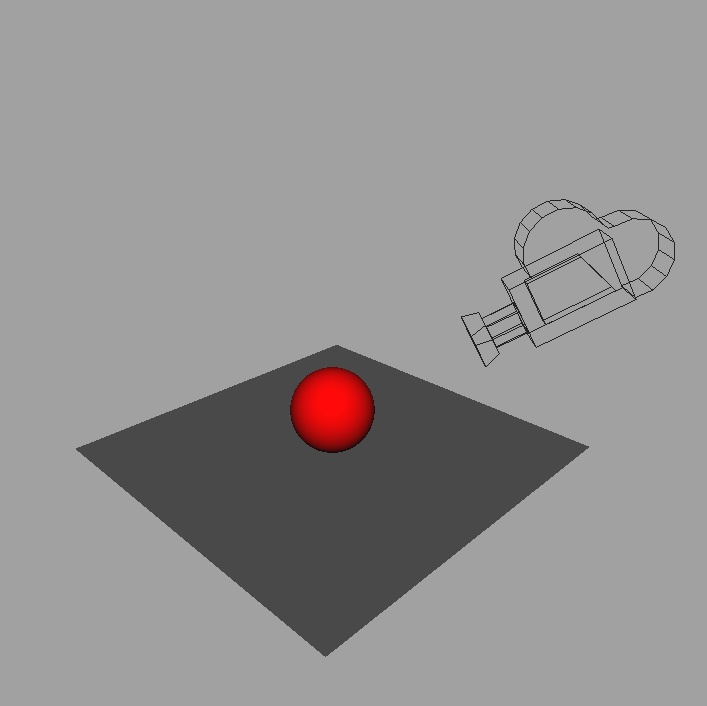

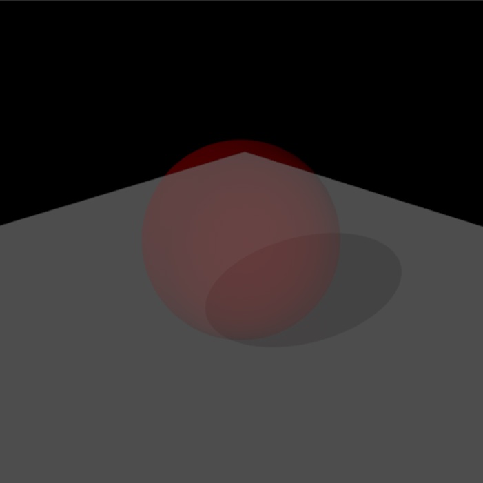

| 3d scene | Deep EXR render |

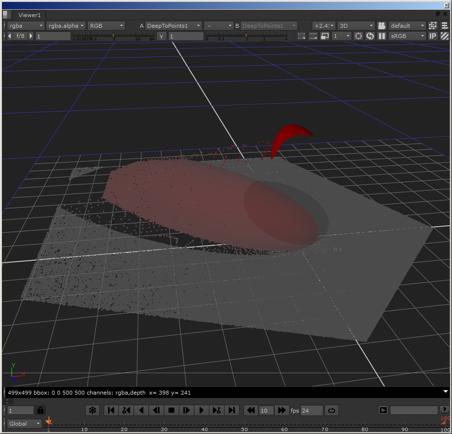

| Node graph in Nuke | 3d view in Nuke |

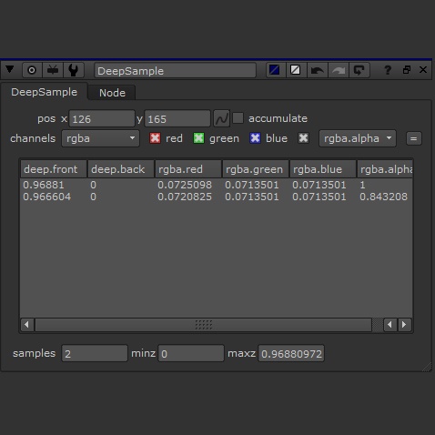

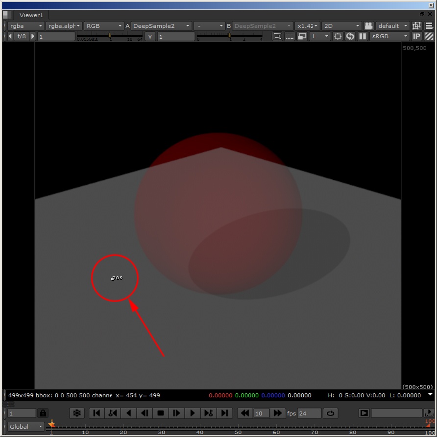

- Select the Deep Sample node. Drag the 'pos' dot in the 2d viewer where you want to view the samples. You should see that there are two samples in the Deep Sample node.
| Deep sample viewed in 2d | 2 Deep samples viewable in 3d | 2 samples exist in Deep Sample node |

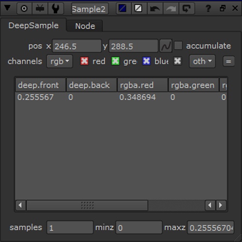

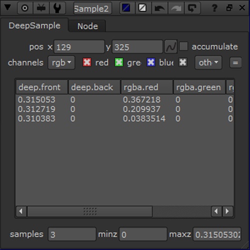

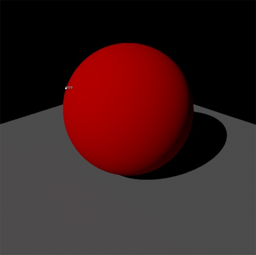

Subpixel merge's effect is obvious when we view a pixel at the edge of the sphere compared to a pixel that is in the center. The pixel at the edge of the sphere will get more deep samples to preserve the detail in the antialiased edge:
One sample is visible in the center of the red sphere
Three samples are visible on the edge of the red sphere

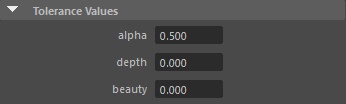

Tolerance Values
If two samples have a layer value difference bigger than this threshold, they will not be merged. You can also specify one tolerance per alpha, depth, and AOV layer.
Two samples will be merged only when the alpha, depth, and every AOV difference values are under the tolerance values.
Alpha Tolerance
If the opacity difference along the depth is smaller than this threshold, samples could be merged. Any samples that fall out of this threshold difference value will be merged, and only the samples that have a larger value than the tolerance value will remain.

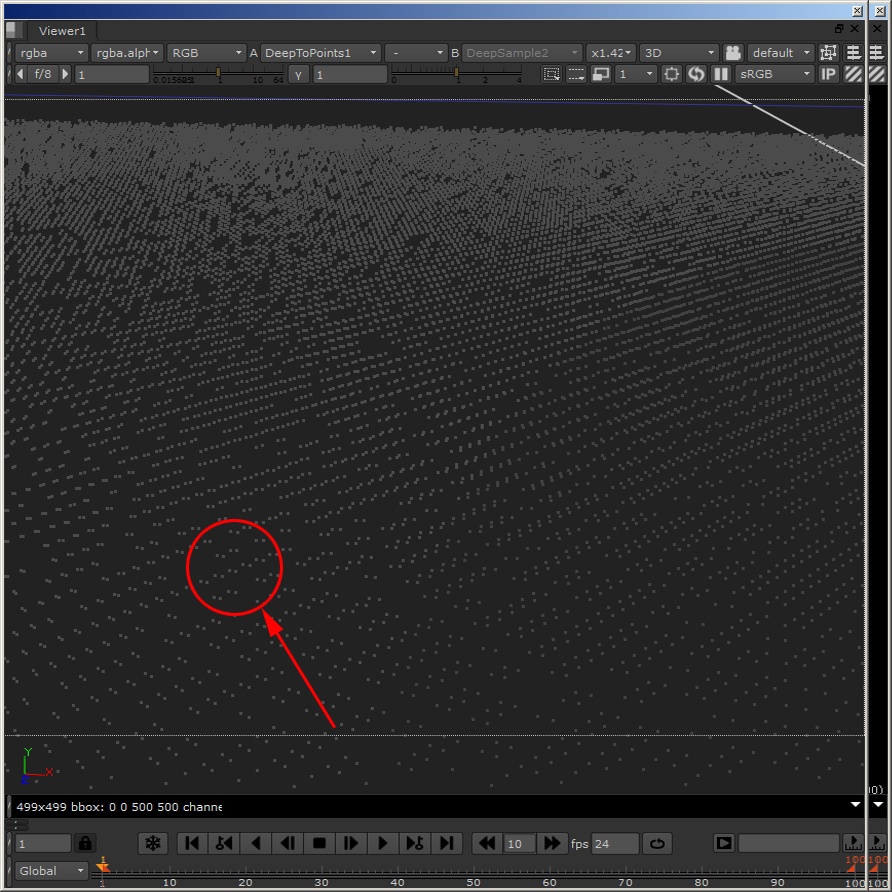

If we reduce the tolerance values to zero, we will get many samples when rendering the scene and viewing it in Nuke (see below).
| Alpha Tolerance: 0 |
However, if we raise the tolerance values (see below), we are effectively creating a threshold by which the samples are merged.
