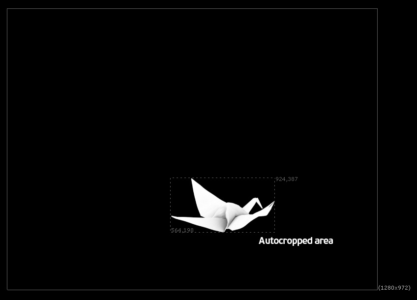

Autocrop
Autocrop removes pixels where alpha and all other channels are zero. It contains a bounding box around the content of the image, which informs a compositing application which part of the image needs to be identified and which part can be skipped. This is particularly useful when you have a CG element that is not filling the whole frame (see image below). Only a small part of the image will be processed in the compositing application. Therefore, it will only load the data window and skip the rest.
The autocropped area that has been identified in a compositing application
