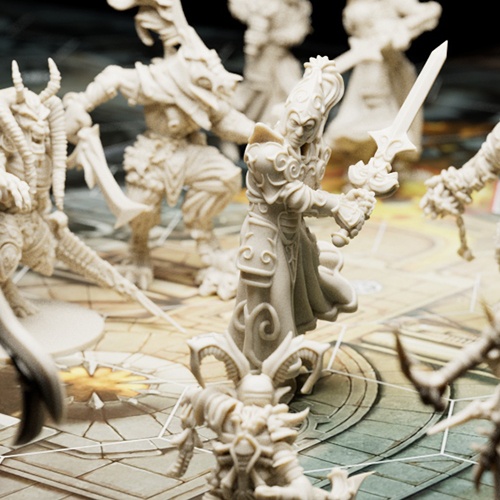

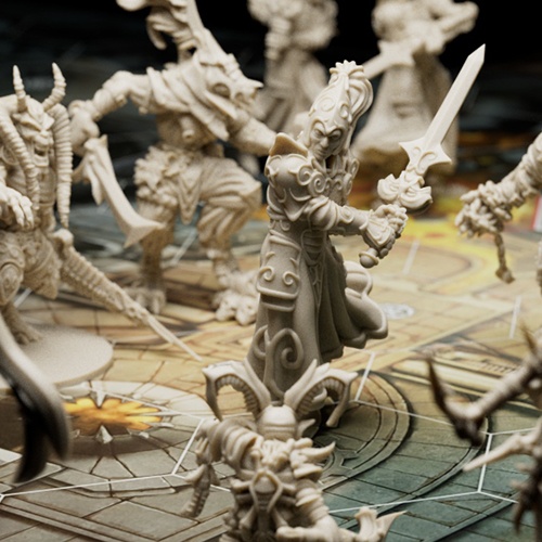

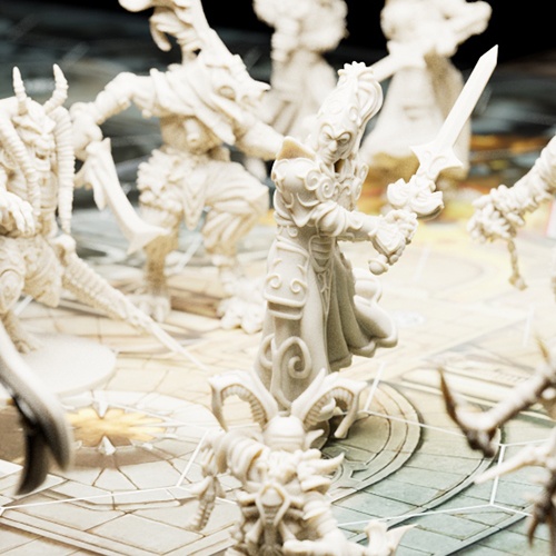

Exposure
Exposure compensation amount in stops.
0 (default) 1 2
