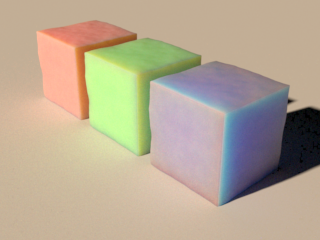

Color Correct
Lens Effects ( vignetting)

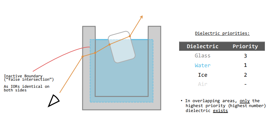

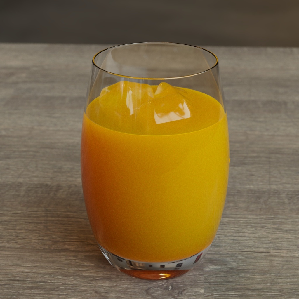

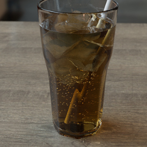

Nested dielectrics : Physically-correct reflection and refraction of rays in scenes with adjacent dielectrics, such as liquids in glass vessels, has been implemented by resolving overlapping, i.e. "nested", dielectrics via a priority system. This allows for more realistic renders of scenes such as glass containers with liquid contents and bubbles, correctly accounting for the change in the index of refraction as rays refract through the transparent media. The new dielectric_priority parameter on the standard_surface shader assigns a priority to the internal dielectric medium of the closed transparent object the shader is assigned to. These priorities specify that in an area of overlap of two transparent objects, only the highest priority dielectric medium exists (see the schematic glass of water below). The priority is simply a signed integer (default 0), which can be increased or decreased as needed to define the dielectric medium in the overlap areas. If priorities are made equal, then media are effectively blended in the overlap. The effect can be disabled globally with
options.dielectric_priorities
( Nested Dielectrics in the Advanced tab of the render settings) in case you need to revert to the legacy mode, which does not correctly compute the refractions. (core#6023)Standard setup of a glass of water with an ice cube, using the priority system. Rollover image to view the result with the global dielectric_priority: disabled (not physically correct).
Nested dielectrics examples

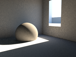

Improved progressive and adaptive sampling : Better sampling now results in much faster noise convergence, especially with adaptive sampling enabled. (core#9941)
Left: Arnold 6.0.4.1 - Right: Arnold 6.1.0.0 - Both images rendered using the same settings: a daptive_threshold = 0.015 (default)

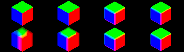

. This can be used when you need to access both the toon AOVs and the core's LPE AOVs. (core#9823)Improved soft creases in adaptive subdivision : Normals for soft creases follow the geometry closer for low iterations. (core#9971)
All cube edges have sharpness 3 creases. The diagram shows the new (top) and old (bottom) normals for 1, 2, 3, and 4 iterations.

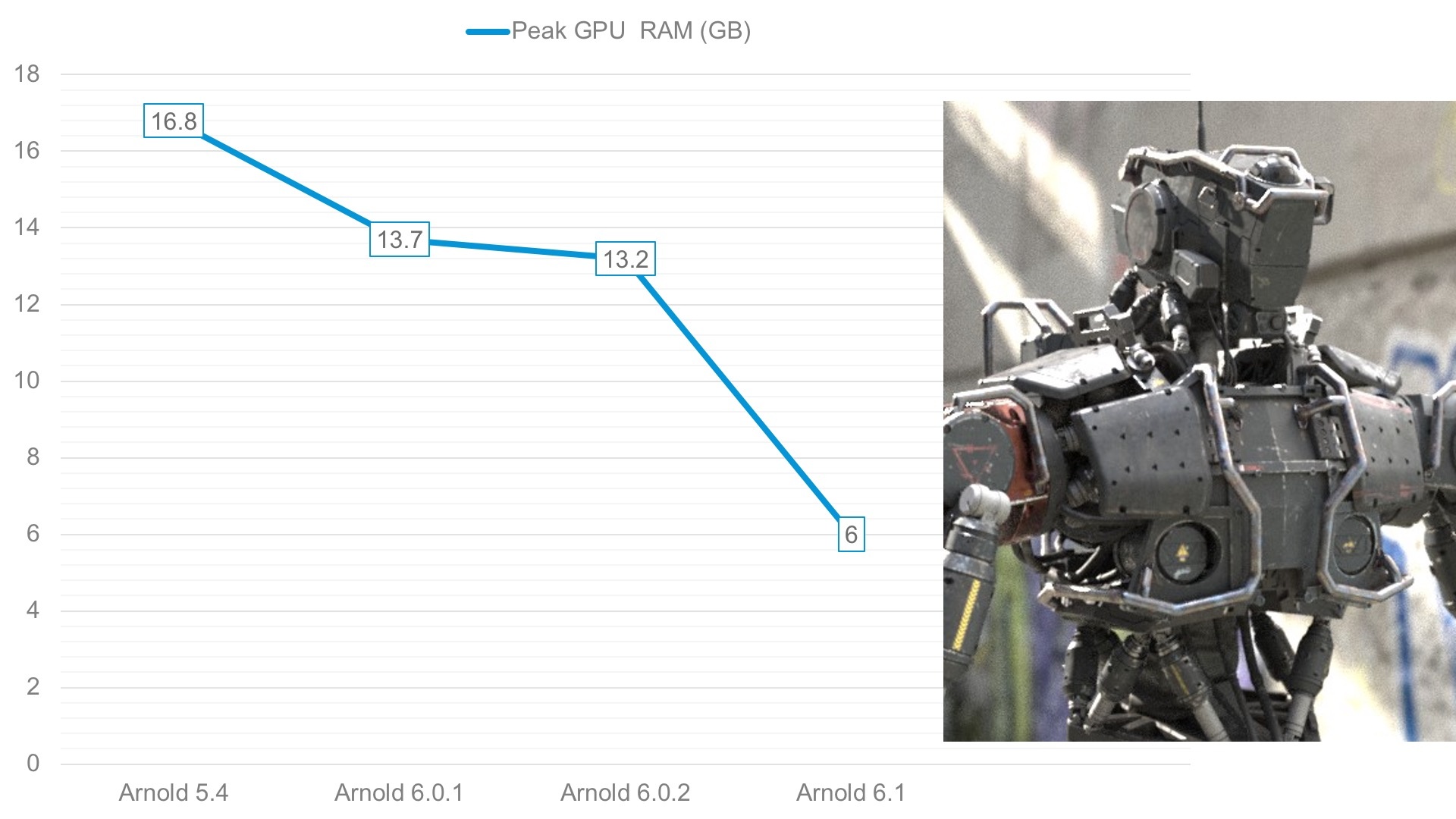

- Improved on-demand loading of textures : The GPU renderer can now partially load textures which results in important GPU memory savings when using tiled and mipmapped textures, such as from .tx textures. In a typical scene, the amount of memory needed for textures could be reduced to be up to 5x smaller. A recent driver is needed for this feature (core#9984).
