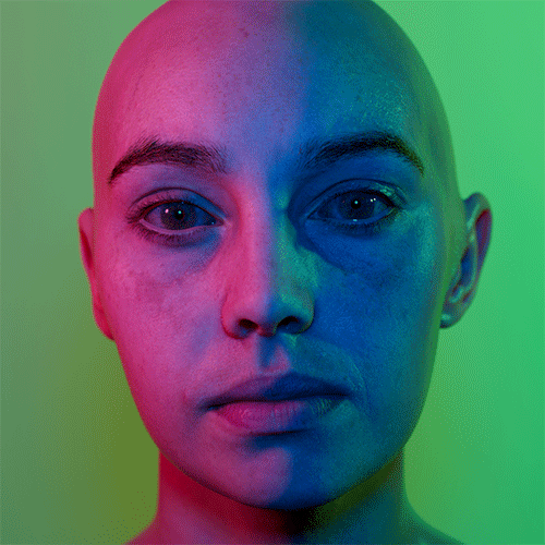

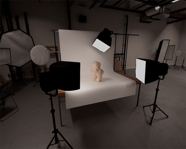

Light Mixer imager : This new imager makes it possible to interactively edit the contribution of light group AOVs during and after rendering without restarting the render (core#9838).

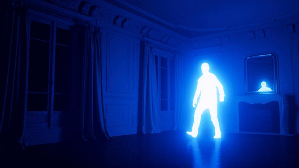

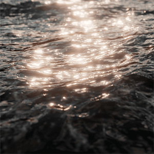

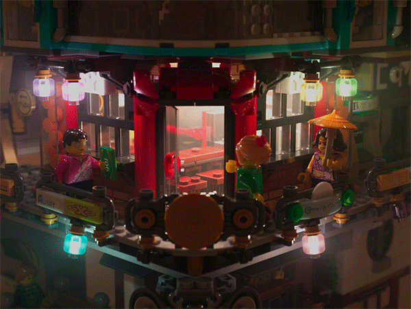

Bloom in imager_lens_effect : The imager_lens_effect now implements a bloom effect. Bloom or glow is a post-processing effect that will blur pixels above a given threshold across the frame to simulate light bleeding on an imperfect lens. See the (core#9728).

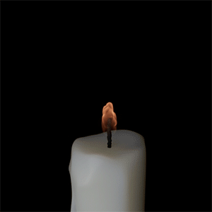

  • Look change to blackbody: A bug fix in blackbody emission math will cause a slight change in intensity and color, resulting in brighter values. This affects the blackbody shader and temperature color pickers. (core#10074)
