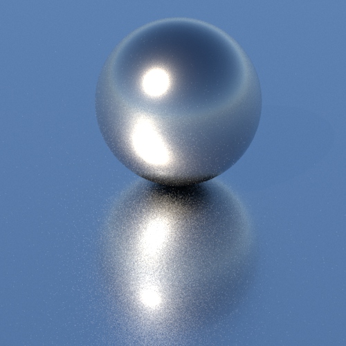

Pixel clamping can be useful in scenes that contain 'spike noise' or 'fireflies': isolated, super bright pixels that jump around from frame to frame.

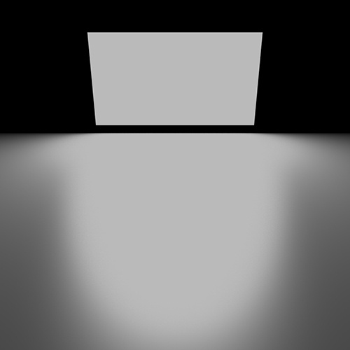

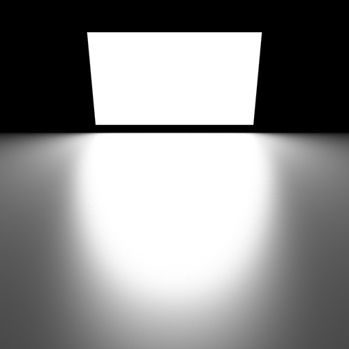

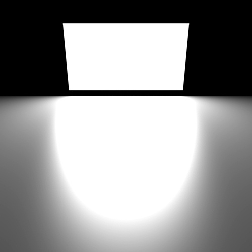

If enabled, this control will clamp pixel samples to this specified maximum value. This can make it easier to anti-alias certain high-dynamic-range effects, such as bright motion-blurred specular streaks (at the cost of reduced contrast). What is clamped is the resulting output value of the renderer computations of each pixel sample. Example: If the Max Clamp Value is set to 2, no pixels will have an RGB value greater than 2.0, 2.0, 2.0.
| 10 (default value) | 1 | 0.5 |

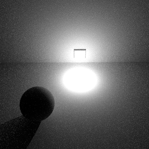

The threshold to clamp away fireflies from indirect light samples and reduce noise. This works similarly to AA Sample Clamp but preserves specular highlights from direct lighting. Lower values result in more aggressive noise reduction, possibly at the expense of dynamic range.
| 10 (default value) | 4 | 1 |
