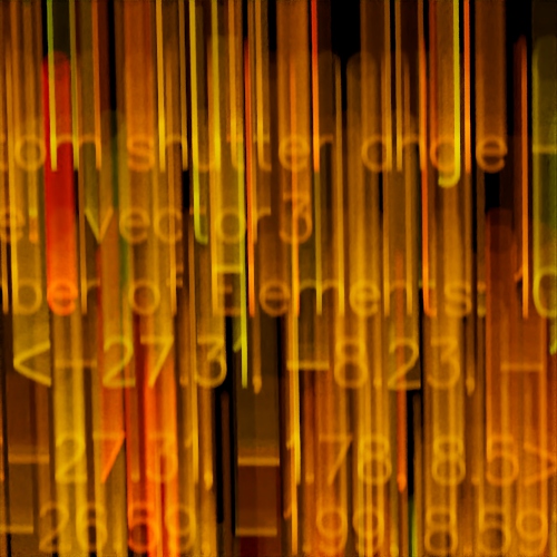

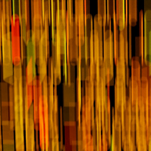

Motion Blur Noise
Very long key ranges will produce exaggerated motion blur, but will also cause more noise to appear within the motion blur trail. Increasing the number of Camera (AA) samples is the only way to reduce this noise.
| Camera (AA) samples: 3 | Camera (AA) samples: 6 |

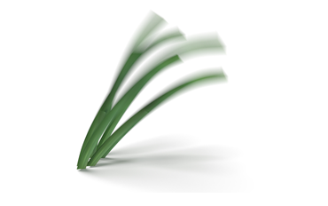

Deformation
This option specifies whether motion blur will take into account geometry deformation. This should only be enabled when objects in the scene change shape quickly enough, since this option uses more memory and renders more slowly.
Adding motion blur to hair also requires Deformation Keys. It is enabled by default.
| Deforming objects, such as hair or gras,s require deformation motion blur |

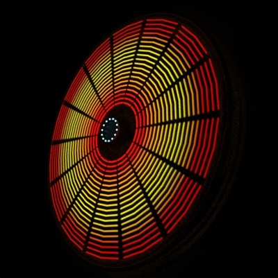

Keys
The number of sub-steps used for motion blur can be set in the keys attribute within the Motion Blur settings. For situations where there is a direct movement, such as translation and rotation with constant speed, two keys are enough. However, if the object moves erratically during the exposure interval or performs any other kind of non-linear movement, you will need to increase the number of keys.
Increasing the number of keys does not usually have much effect on rendering times, although it requires more memory to store the additional geometry multiple times, especially for large polygon meshes.
Below are examples where an increase in the number of keys is required. Notice that increasing the number of keys rounds off the corners of the spinning wheel:
| keys: 2 (default) | keys: 3 | keys: 4 |

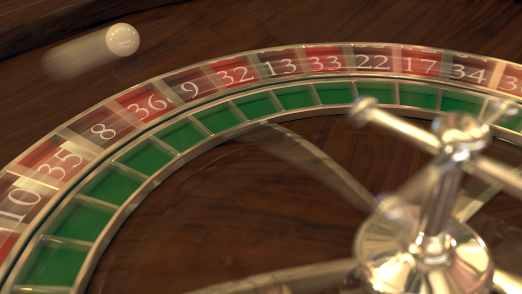

Shutter Controls
Position
Specifies an Offset for the shutter’s time interval, which allows you to change the motion blur trails. The Position offsets the motion blur within the image. It is a relative value that extends towards the frame.
This setting allows you to control when the camera shutter opens and closes relative to the frame being rendered.

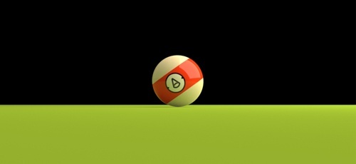

Start on Frame
The shutter opens at the current frame. For example, rendering frame 5 with a length of 1 would result in the times 5.0, 5.5, and 6.0 being calculated.

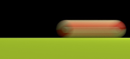

| Pool ball positioned in center | Start on frame |

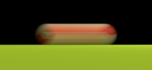

Center on Frame
The shutter is open during the current frame. For example, rendering frame 5 with a length of 1 would result in the times 4.5, 5.0, and 5.5 being calculated.
| Pool ball positioned in center | Center on frame |

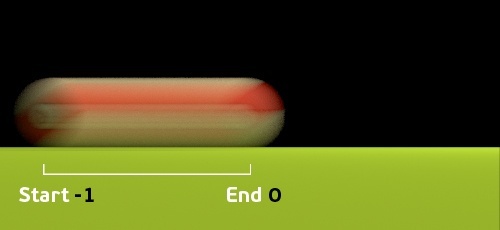

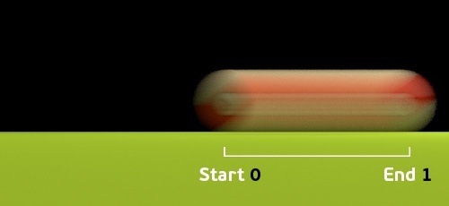

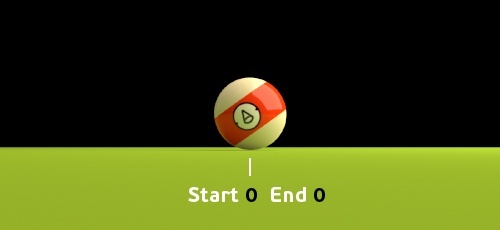

Custom
Allows you to define the start and end points for the motion range.
| Custom shutter angles rendered at frame 0 |

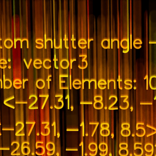

Another example using a custom Shutter Length.
| start: 0, end: 0.5 | start: 0, end: 1 | start: 0, end: 2 |
Length
| shutter length: 0. No blur. | shutter length: 0.5 (default). 180º. | shutter length: 1. 360º. |

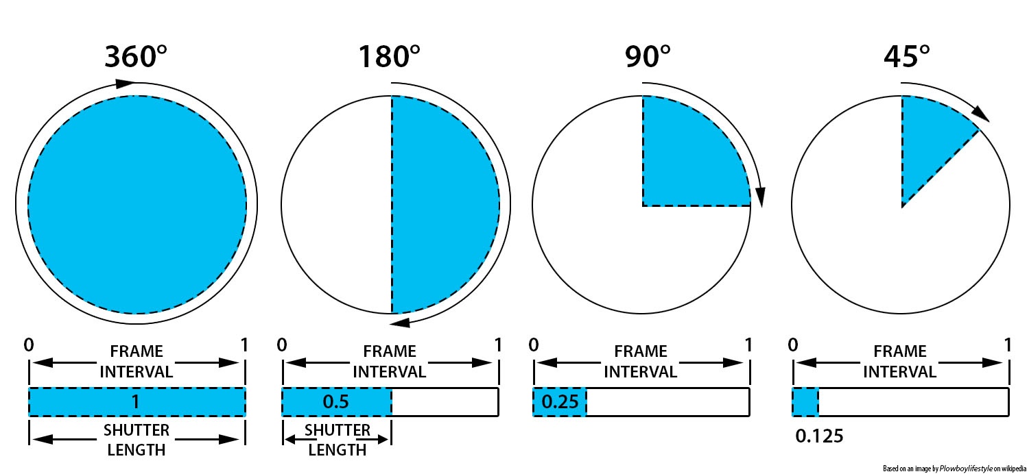

To get a 180-degree shutter angle, you should use a length of 0.5 frames (since the exposure time will be 1/48s (assuming you are using 24 fps), which is the equivalent of 0.5 frames).
To get 360 degrees, you should use a length of 1, and to get 90 degrees, you would, therefore, use a value of 0.25.
A value of 0 yields no motion blur, while larger values create longer blurred trails, simulating a faster speed. The standard value is 0.5, equivalent to a 180° shutter angle.
The shutter length is equivalent to the exposure time above.
- 45° shutter angle = Shutter length 0.125
- 90° shutter angle = Shutter length 0.25
- 180° shutter angle = Shutter length 0.5
- 360° shutter angle = Shutter length 1

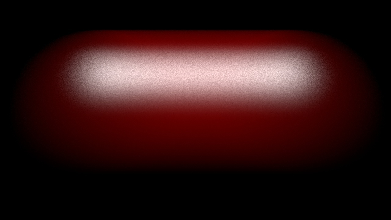

| Example of a long shutter length |
The Shutter Length and characteristics can be further controlled in the camera.
