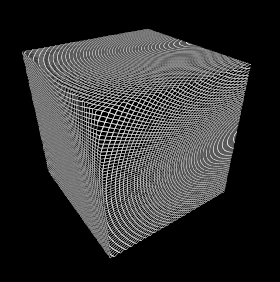

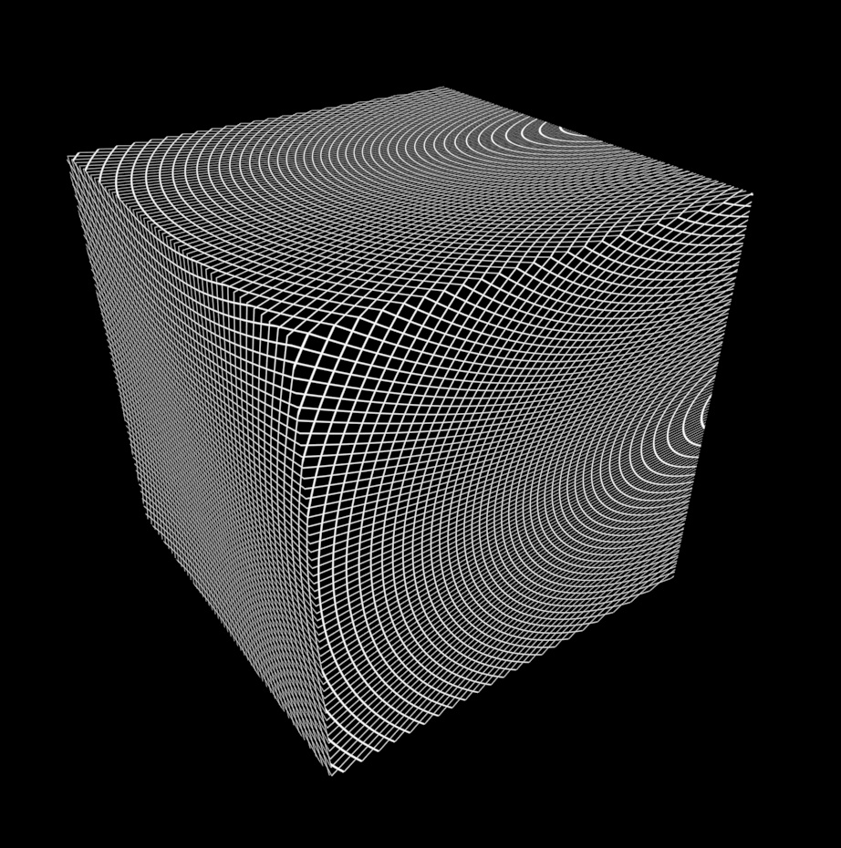

2 | 3 | 4 |

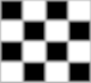

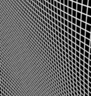

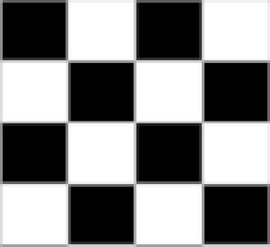

This example demonstrates the effect filter width can have on moire effects in your images. Increasing the filter width setting helps to reduce the moire effect.
This is more noticeable on the left side and top of the cube.

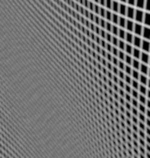

2 | 4 |
Close up of filter width: 2 | Close up of filter width: 4 |

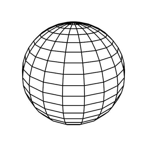

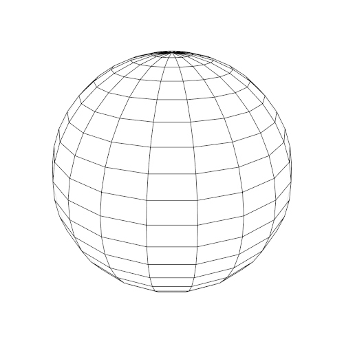

1 | 2 | 3 |
