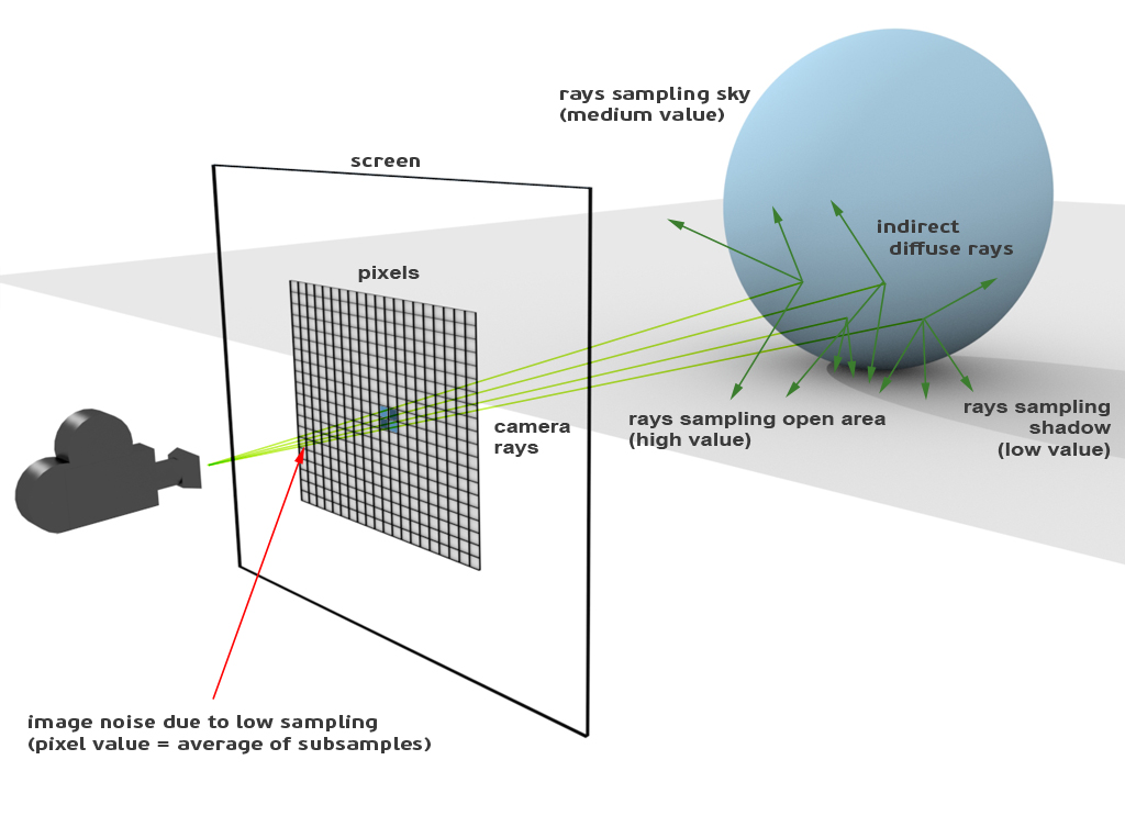

When Diffuse Samples are more than zero, camera rays intersecting with diffuse surfaces fire indirect diffuse rays. The rays are fired in random directions within a hemispherical spread. Noise is introduced when there are insufficient rays to resolve the range of values from the environment.
Increasing the number of Diffuse Samples will increase the number of diffuse rays fired from a point:

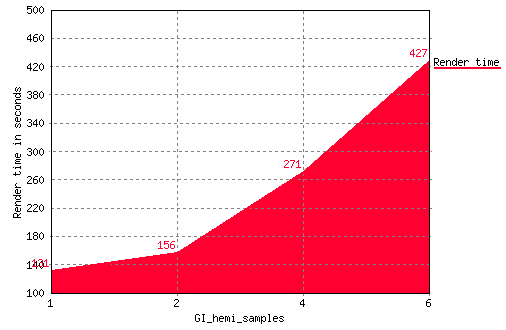

The table below shows the effect of increasing the number of Diffuse Samples to resolve indirect diffuse noise:
| Diffuse_samples: 1 2 4 6. Render time: 131 156 271 427 |
This shows the performance impact when increasing the number of Diffuse Samples (GI_diffuse_samples). Because indirect diffuse rays are so prevalent, this can get expensive. In this example, the performance hit from 1 to 6 samples was over 320%.

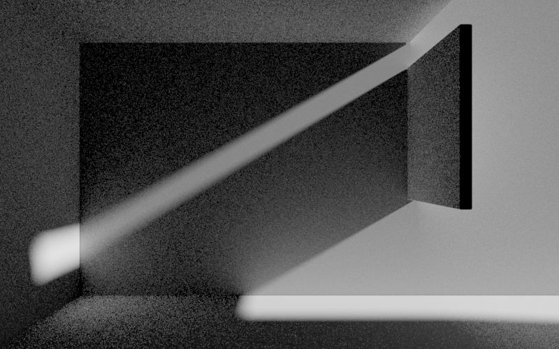

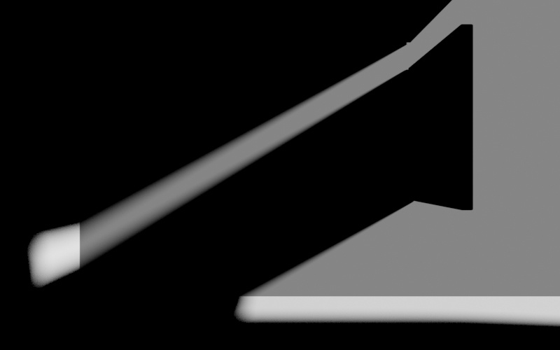

Indirect diffuse noise
This is one of the most common causes of noise and can have a number of different sources. It manifests as granularity in the scene, usually in shadowed areas.
There are a couple of different methods to determine indirect diffuse noise. If you've rendered AOVs, you can check the indirect diffuse AOV; if noise is present in this AOV only, you can be quite certain this ray type is responsible. You can check if an area of noise is created by indirect diffuse noise by turning Diffuse Samples to zero; this will effectively turn off indirect_diffuse. If this ray type is responsible, then the noise will disappear. If the image darkens with the indirect diffuse gone, but the noise is still present, indirect diffuse rays are not responsible for the noise.
In the example below, a directional light is pointing into an enclosed space. With Diffuse Samples set to 0, no light can bounce off the surfaces, and therefore, there is no indirect light in the scene. Increasing the Diffuse Samples to 1 allows diffuse rays to bounce around the scene. However, it produces a noisy result, especially in the corners of the scene. Increasing the Diffuse Samples to 3 gives an improved result. It is good practice to use this value sparingly. Increase it incrementally and see if you notice any difference in the quality of the indirect_diffuse component.
| 0 (only direct light with no GI diffuse bounces) | 1 (noise due to low number of samples) | 3 (increasing this value gives cleaner GI diffuse results) |
Remember that the diffuse sampling is done for each Camera (AA) sample, so high values for both Camera (AA) samples and diffuse samples will tend to result in slow renders.

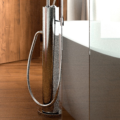

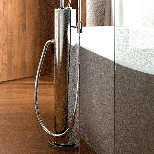

Diffuse Surfaces Through Reflections
In scenes where you have both directly visible diffuse (bath) and diffuse visible through reflections/refractions (chrome reflection), increasing the Diffuse Samples will only help to improve the directly visible diffuse noise. Whereas increasing the Camera (AA) samples will improve everything uniformly (the entire image).
| Camera (AA): 5. Diffuse: 1 | Camera (AA): 5. Diffuse: 5. Noise still visible in reflection. | Increasing Camera (AA) samples improves the noise |
| Diffuse samples only affect directly visible diffuse surfaces and nothing else |

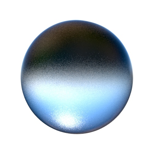

Controls the number of rays fired when computing the reflected indirect-radiance integrated over the hemisphere weighted by a specular BRDF. The exact number of rays is the square of this value. Increase this number to reduce the indirect specular noise (soft/blurry reflections). Remember that the specular sampling is done for each Camera (AA) sample, so high values for both Camera (AA) samples and specular samples will tend to result in slow renders.
| Diagram showing how specular reflection rays are propagated in an Arnold render |
In the example below, the mirrored surface has a high Specular Weight and Specular Roughness values. In the image on the left, you can see that there are not enough GI_specular_samples and therefore there is noise in the mirror. Increasing the Specular Samples gives a better result.
| 1 | 4 |
If you reduce the number of Specular Samples to zero and the Specular Ray Depth to zero, and the noise disappears, then the noise is due to specular reflections.

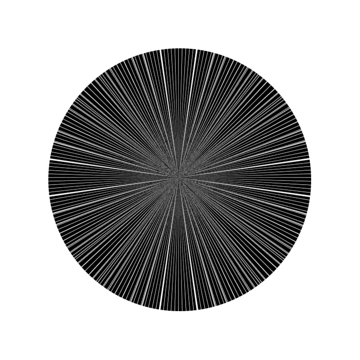

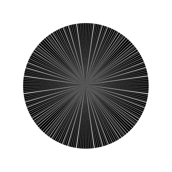

Transmission
Controls the number of samples used to simulate the microfacet-based transmission evaluations. Increase this value to resolve any noise in the transmission. If you switch this parameter to zero, the GI Transmission Depth to zero, and the noise disappears, you will know that the noise is due to transmission.
| 2 | 4 | 6 |

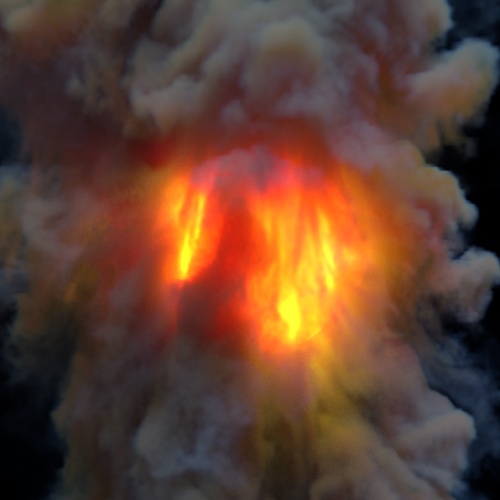

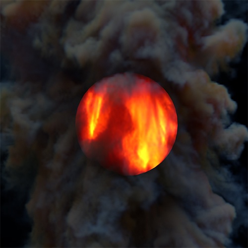

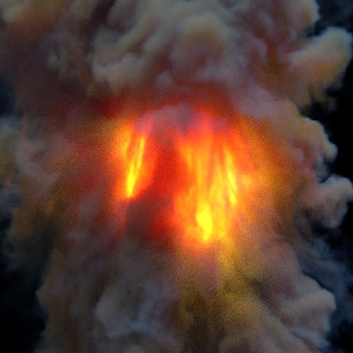

Volume Indirect
Controls the number of sample rays that get fired to compute indirect lighting of the volume. Like the other sampling rate controls (Camera (AA), Light Samples, diffuse samples, etc.), the number of actual samples is squared, so a setting of 3 fires 3x3=9 rays. Setting it to 0 turns off the indirect lighting of the volume. Note that indirect volume lighting is tied to the Volume Ray Depth render option, and therefore, there must be at least 1 volume bounce for indirect lighting to be computed.
| 0 (volume ray depth: 1) - No indirect volume lighting | 1 (volume ray depth: 1) - Volume has indirect lighting but needs more samples | 4 (volume ray depth: 1) - Increasing the samples reduces the noise |
Info: Volume Indirect samples and per-light Volume Samples do not apply to Atmosphere Volume. To improve the quality of the Atmosphere Volume you must increase the Atmosphere Volume Samples.
