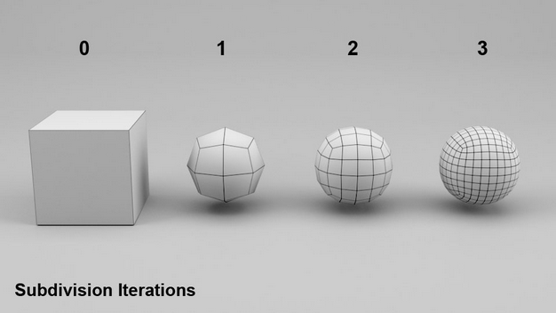

Max. Subdivisions
This value sets an upper limit on the number of subdivision iterations for all objects. By default, this is set to a very high value (999), which in practice has no effect. Setting this to a low value, such as 1 or 2, can be useful when debugging scenes that take a long time to subdivide/tessellate.
| Cube subdivided with 0, 1, 2, and 3 subdiv iterations (objects shaded with the utility shader in polywire mode). |

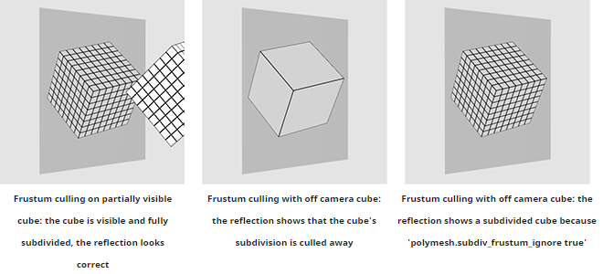

Frustum Culling

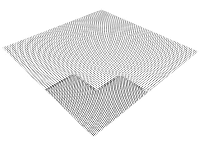

Subdivision patches outside the view or dicing camera frustum will not be subdivided. This is useful for any extended surface that is only partially visible, as only the directly visible part will be subdivided. Similarly, no subdivision work will happen if a mesh is not directly visible. This can be turned on globally by setting options.subdiv_frustum_culling true and can be turned off for specific meshes with polymesh .subdiv_frustum_ignore true.
| Frustum culling on ground plane as seen from the render camera | Frustum culling on ground plane as seen from above, with previous render camera set as dicing camera |

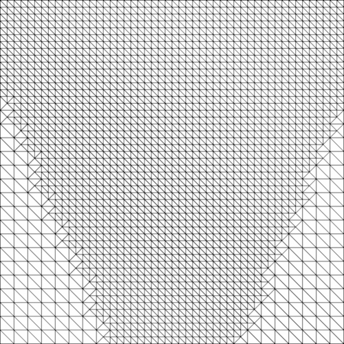

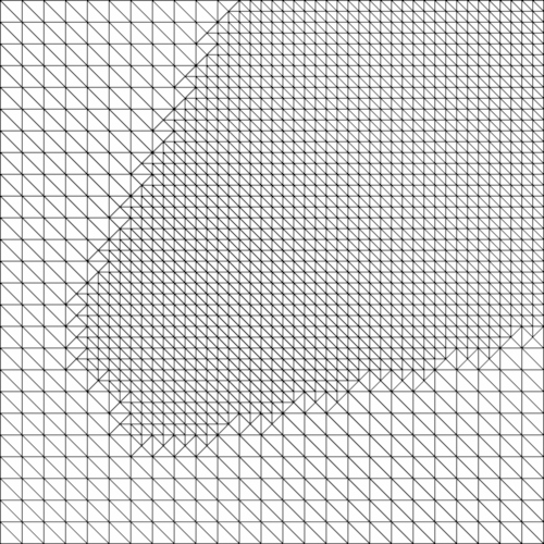

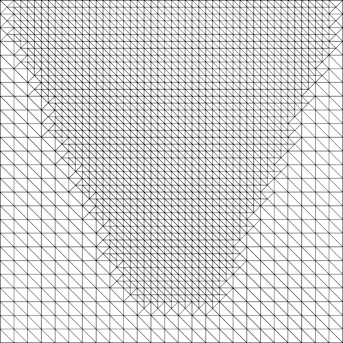

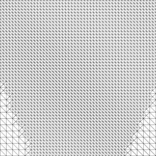

Frustum Padding
Adds a world space padding to the frustum that can be increased as needed to minimize artifacts from out-of-view objects in cast shadows, reflections, etc. Note that motion blur is not yet taken into account, and moving objects might require some additional padding.
| 0 | 0.1 | 0.2 |

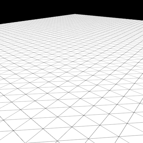

Dicing Camera
The camera to use when determining subdivision levels of patches during adaptive subdivision. When enabled, the user provides a specific camera that will be used as a reference for all dicing (subdivision) calculations during Adaptive Subdivision (in other words, the tessellation of the object will not vary as the main camera is moved). This can be useful to fix objectionable flickering introduced by Adaptive Tessellation with certain moves of the main camera. If you set a static dicing camera, you will still get the benefits from Adaptive Subdivision (higher polygon detail closer to the dicing camera) while getting a tessellation that does not change from frame to frame. By default, this is disabled and should only be used when necessary, and with a carefully chosen position for the dicing camera.
| Polygon plane rendered with dicing camera (catclark subdivision with 10 iterations) |
