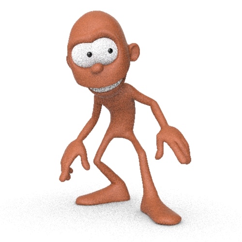

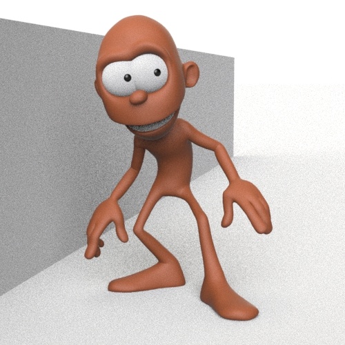

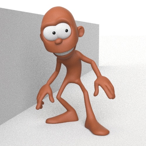

Renders computed with too few samples in each pixel can be noisy. Increasing the number of samples per pixel gives a less noisy image that better represents the actual scene. The images below show a comparison when increasing the number of Camera(AA) samples in a scene. Not only does increasing Camera(AA) samples reduce aliasing noise, but it also adds more secondary ray samples, which also reduces noise in the lighting.
| 1 Camera (AA): 1x1=1 sample per pixel (image appears noisy) | 6 Camera (AA): 6x6=36 (noise is reduced) |

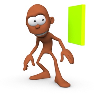

| Direct lighting only (diffuse samples: 0) | Indirect (diffuse) lighting from emissive green cube |
Indirect diffuse rays are rays that interact with objects and their surface shaders. Therefore, rays travel in the scene in directions determined by the shader assigned to the object. Transmission rays travel through objects. When a ray hits a reflective object, such as a mirror, only one reflection ray is traced from that point in a direction determined by the incoming ray. In contrast, diffuse rays are sampled randomly over the hemisphere around the hit point.

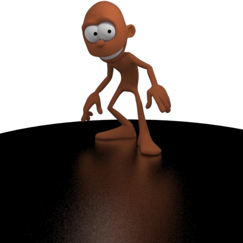

When rendering glossy specular surfaces, noise can also be a problem, as with diffuse rays. Bright hotspots can cause noise in indirect specular samples. For example, wide specular reflections of small, bright lights. If the issue is noise in a specular highlight, it needs to be confirmed that the source is the direct light and not a secondary ray type (such as specular). This is easy to achieve by setting the Diffuse Ray Depth, Specular Ray Depth to zero (this essentially turns off all global illumination). If the noise is still there, we know it is the direct specular component of the illumination model. In most cases, it can be resolved by increasing the number of specular samples.
| 1 (insufficient samples) | 4 (sufficient samples, noise is reduced) |

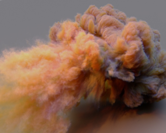

At each step the ray travels, it evaluates the shader and accumulates the density of the volume. When these density values become more erratic throughout the volume, nearby rays can calculate substantially different values, introducing noise into the render. In this case, it may be necessary to render using more light volume samples or to reduce the step size in the volume. Even with low sampling values, it can be expensive to render clean images with volumes.
| Light volume samples: 1 | Light volume samples: 6 |

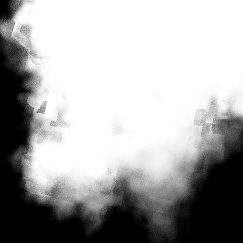

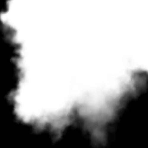

The Step Size of the ray marching process. Too low a sampling rate here will cause the volume rendering to miss small details in the volume, making them noisy, making them thinner than they should be, or making a bad estimate of the exact position of the 'surface' of a 'solid' volume like a pyroclastic cloud. A bad Step Size has a snowball effect that can make the rest of the sampling process noisier. This is pretty easy to test by looking at the alpha channel, or by adding some emission to the volume and turning off all lighting. If the emission/alpha channel is noisy at the desired Camera(AA) setting, then the Step Size is probably too large.
| step size correct | Artifacts appear in the alpha when the step size is too large |

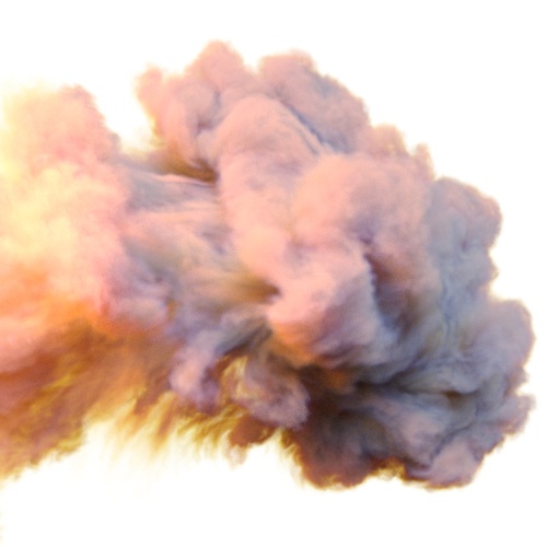

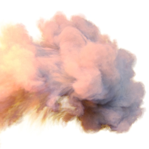

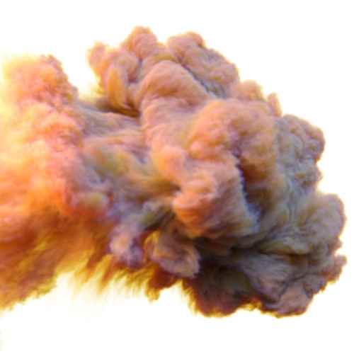

Increasing the Volume Ray Depth can make a dramatic difference to the appearance of a volume. However, be aware that increasing the volume ray depth will increase the number of multiple scattering bounces within the volume (defaults to 0), and therefore render times will increase significantly.
| 0 | 6 |
