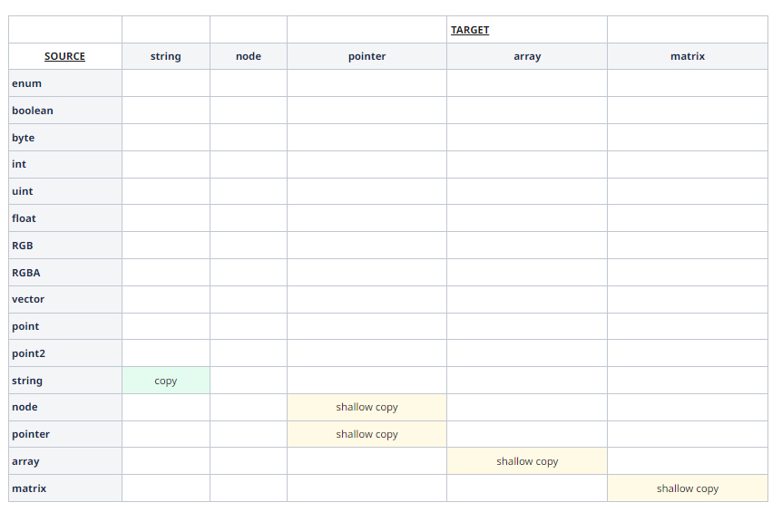

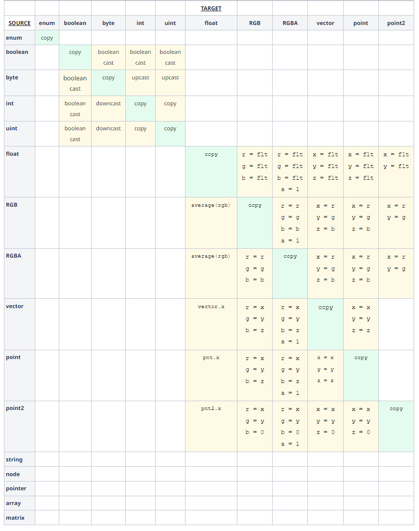

When shader parameters are connected together, some allowance is made for parameters to be connected when they have different types. Here are the rules for automatic parameter conversions.
Key:
| (empty) | conversion is disallowed/ignored |
| copy | copy (no need to convert) |
| expand | all components set to the same source value |
| shallow copy | for pointer types (pointer, node, array, matrix), copy the pointer, not the actual value |
| boolean cast | zero means false, non-zero means true, and vice-versa |
| upcast | smaller integer type just gets stuffed into a larger integer type |
| downcast | larger integer type gets truncated into a smaller integer type |
| average | the average of the components are taken |

- The node type (AI_TYPE_NODE) is currently resolved at scene creation time, and node-to-node shader connections are not formally allowed since they internally are turned into a connection based on the output type of the shader node. However, whenever one wants to pass a node along, they can pass it as a generic pointer type instead of using other mechanisms such as shader message passing. The vast majority of the time, if you are using pointer passing inside of your shaders, however, you should rethink your design.
- No automatic conversions exist between integer types and floating-point types.
- No automatic conversions exist between enumerations and any other type.
