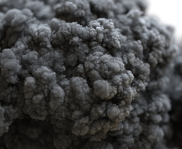

Volume file formats, such as OpenVDB, will allow storage of much larger datasets while being optimized for random access to volume data, which is more efficient for rendering. OpenVDB is an open source C++ library comprising a novel hierarchical data structure and a suite of tools for the efficient storage and manipulation of sparse volumetric data discretized on three-dimensional grids.
Volumes can only receive indirect lighting from other emissive volumes when the volume_ray_depth is above 0. Custom AOVs are not currently supported with volumes. Rendering of volumes should not be confused with atmosphere_volume, which is a global effect.

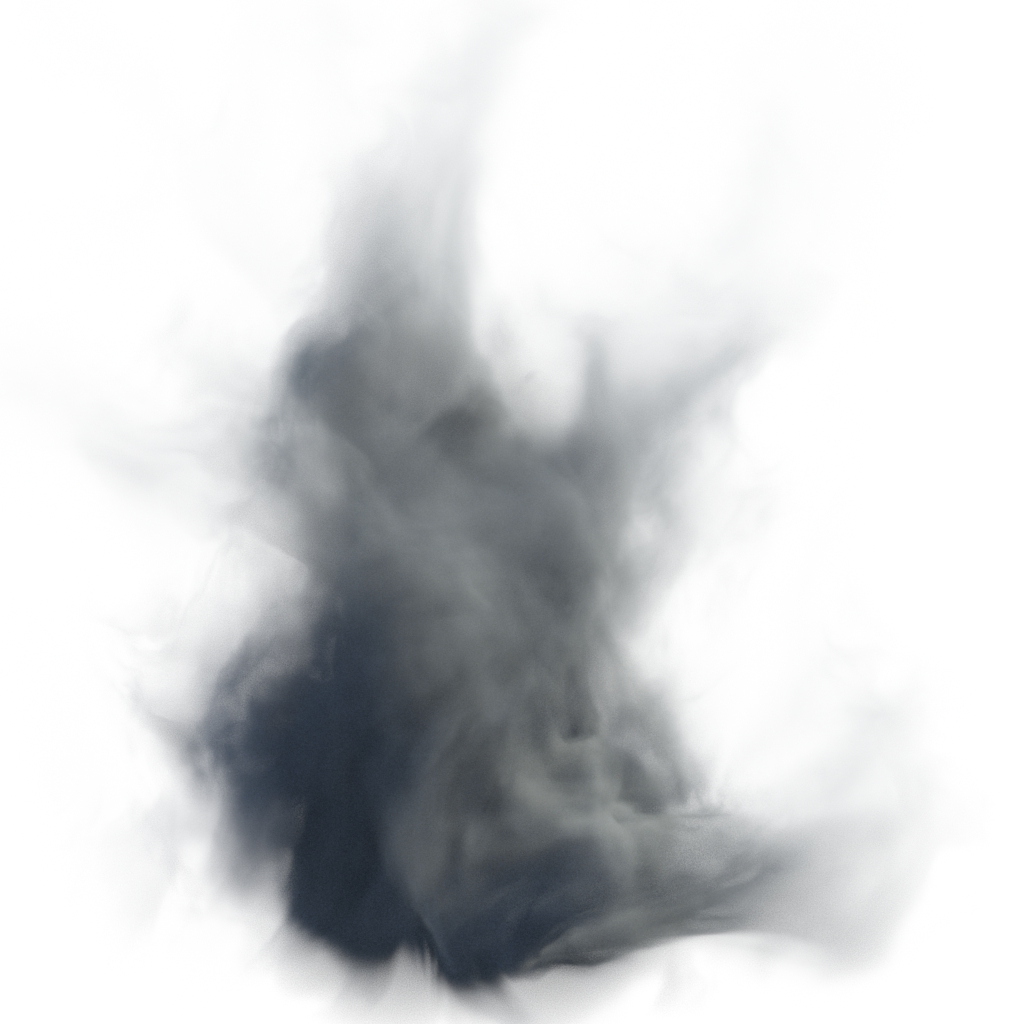

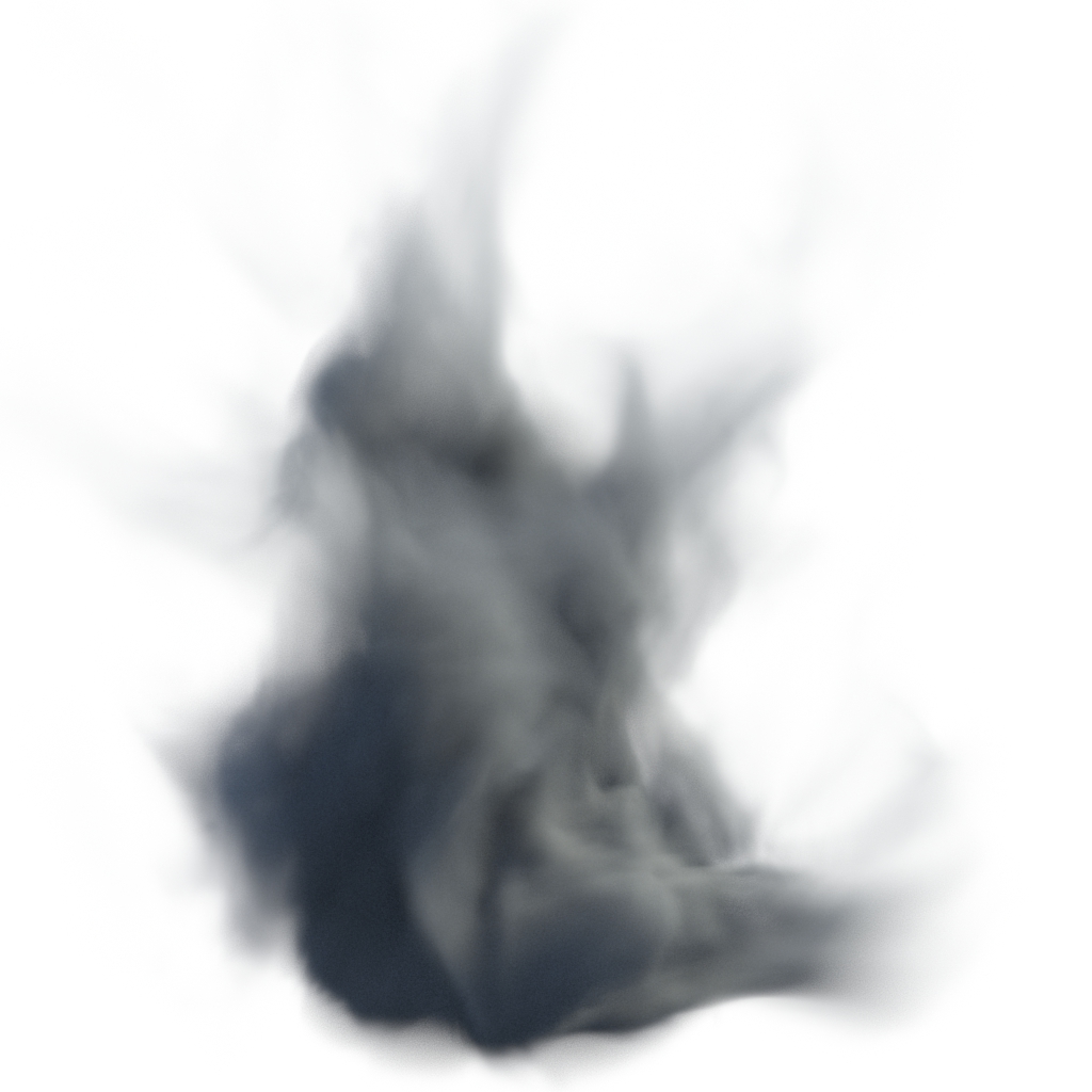

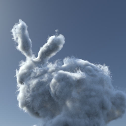

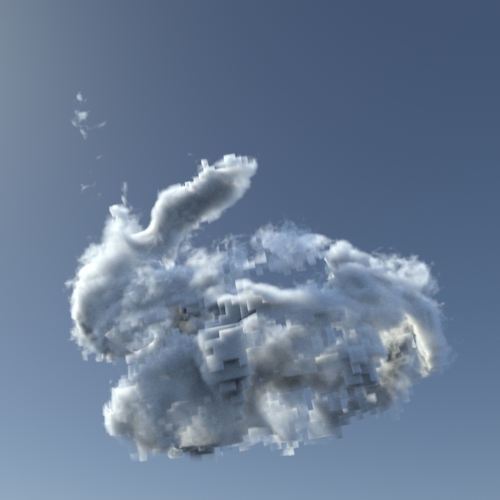

Sets the size for sampling inside the volume. It should be small enough to capture the smallest feature in the volume (aka the Nyquist limit). If the size is too large, aliasing, bias, or banding will appear. Smaller (and therefore more accurate) sizes will increase render times, while larger sizes will render more quickly.
Step_size basically controls the rate at which the volume shader gets called. The value indicates the average distance between adjacent volume shader samples along a given ray, in world space units. Generally, you will want this setting to be as large as possible before visibly noticeable artifacts occur, and in the case of voxelized volumes no smaller than about half the size of your voxels (in world space). A low step_size will increase render times. For example, when the step_size is 0.1 and the volume is 10 units big in world space, there are approximately 100 primary samples and therefore the volume shader is called 100 times.
The step_size has a fixed size; therefore, the larger the container, the more steps will be taken and the longer it will take to render. Also, beware that if the step_size is too small, your render times will increase. If you cannot see the rendered volume, you may need to reduce the step_size value.

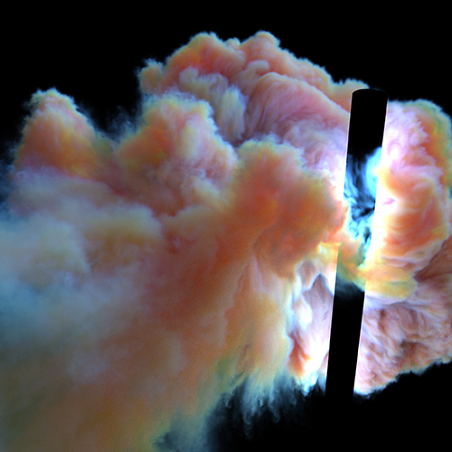

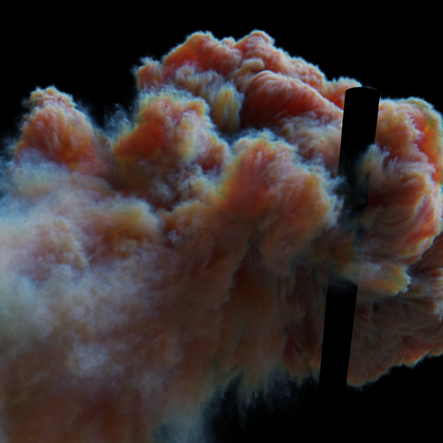

To reduce the amount of noise in a volume, you must ensure that any lights in your scene have sufficient volume samples, or alternatively that you have enough Camera (AA) samples.
| volume_samples: 1 | volume_samples: 3 |

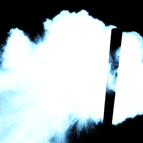

- volume: beauty AOV that contains volumes.
- volume_albedo: volume albedo.
- volume_direct: direct scattering in volumes.
- volume_indirect: indirect scattering in volumes.
- volume_opacity: RGB AOV with the full three-channel opacity.
