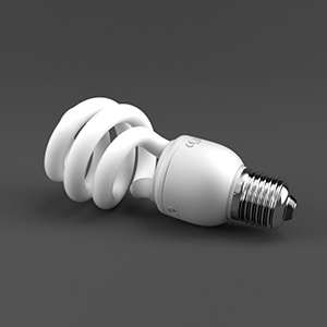

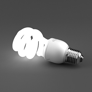

| bulb with emissive shader assigned to it | without emission |

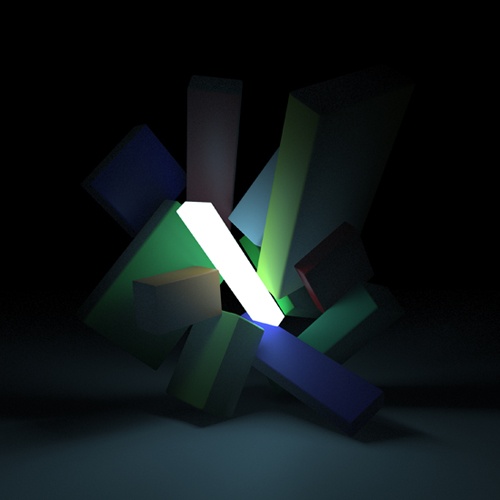

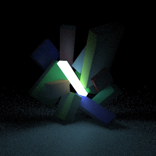

Increasing the number of Diffuse Samples will help to reduce any noise in dark, indirectly lit areas of a scene when using emission.
| diffuse samples: 2 | diffuse samples: 6 |

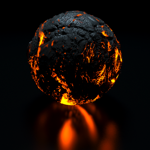

Texture map representing hot lava connected to emission color
