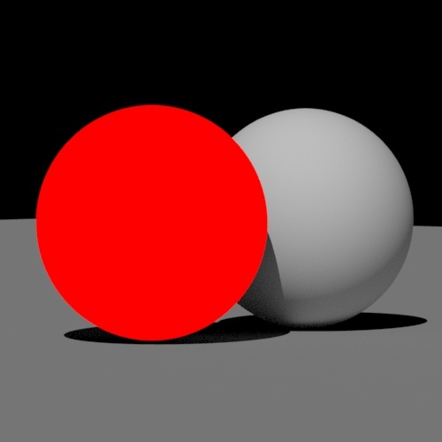

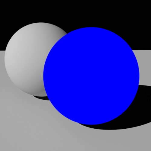

Changes the color of the matte.
| matte color: blue | matte color: red |
