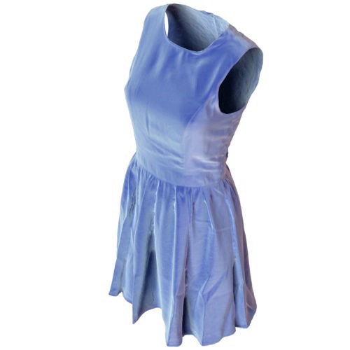

Sheen Weight

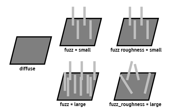

An energy-conserving Sheen layer that can be used to approximate microfiber, cloth-like surfaces such as velvet and satin of varying roughness. Sheen is layered onto the diffuse component, and its weight is determined with this attribute. Sheen can be thought of as the density or the combination of the density and length of the fibers.
| 0 (default) | 0.1 | 0.25 |
As well as fabric, Sheen can be used to simulate leaves, fruit, or the peach fuzz on a face (best when viewed from a distance).

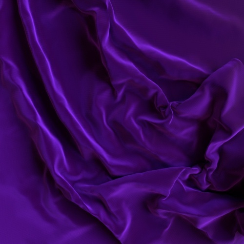

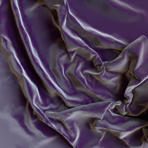

Sheen Color
The color of the fibers. Tints the color of the Sheen contribution.
| white (default) | purple | red |
(base color: dark purple used with above images)

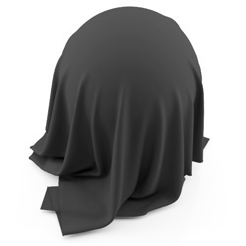

Sheen Roughness
This modulates how much the microfibers diverge from the surface normal direction.
| 0.1 | 0.3 (default) | 0.6 |
sheen roughness randomizes the fiber direction
