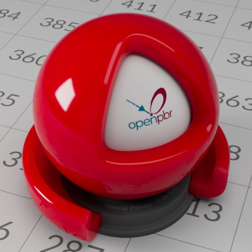

OpenPBR Surface is a digital material model designed as a collaboration between the teams at Adobe and Autodesk, under the guidance of the MaterialX Technical Steering Committee. OpenPBR Surface is a step towards more convergence in the industry and more efficient workflows for 3D content creators. It is a physically based surface model based on Autodesk Standard Surface and Adobe Standard Material and is therefore an evolution of two production-proven models.
OpenPBR Surface is a highly art-directable material model: an expressive yet intuitive set of parameters, neatly grouped, with direct control over the perceived colors, detailed enough to represent most real-world materials. It is physically based, meaning that materials look realistic by default, while still giving artists the freedom to represent imaginary ones. OpenPBR Surface aims to strike a balance between simplicity of use and expressivity. This physically based shading model has been developed to offer creatives a more artist-friendly bridge between different software applications. It is a subproject of MaterialX within the Academy Software Foundation.
The OpenPBR Surface shader is a physically-based shader (like Standard Surface) capable of producing many types of materials. It is intended to be a common interface between products, as well as something practical that works well and looks plausible for most day-to-day use cases.
OpenPBR Surface adopts a specific form of material structure that has proved useful as a general-purpose model in media and entertainment. In outline, the structure consists of:
- A base substrate made of a mixture of metal or dielectric. The interface (dielectric or metal) of this base layer produces the primary specular reflection lobe. The dielectric base represents either of three components, that can be statistically mixed:
- Glossy-diffuse: dielectric with opaque internal media, such as wood, concrete, cardboard, and wall-paint.
- Subsurface: dielectric with highly scattering internal media, such as plastic, marble, skin, vegetation, and food.
- Translucent-base: dielectric with translucent internal media, such as glass, crystals, and liquids.
- Coat: An optional layer of dielectric, which may have an absorbing medium, acting as a coating on top of the base substrate. The dielectric interface of this coat layer provides a secondary specular lobe.

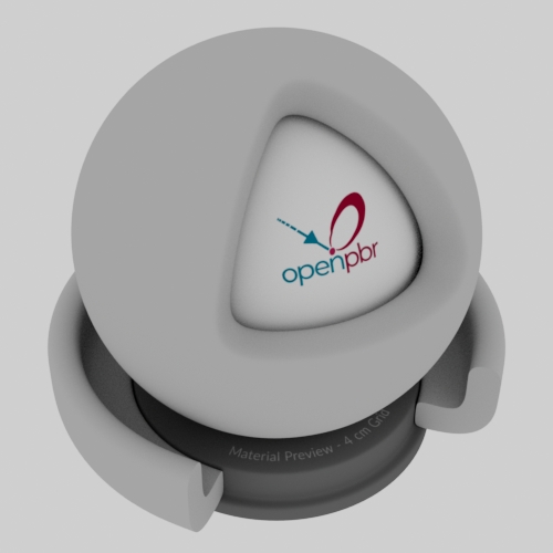

- Fuzz: An optional layer representing the reflection from micro-fibers (such as fine hair, peach fuzz, textile strands, and dust grains) on top of everything else.
It also supports emission, an iridescent thin-film, and a thin-walled mode for modeling two-dimensional, semi-transparent sheets such as window panes, paper, and leaves.

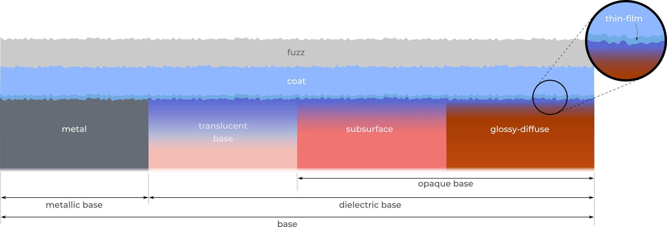

Schematic illustration of the idealized physical material that the OpenPBR Surface shader models.

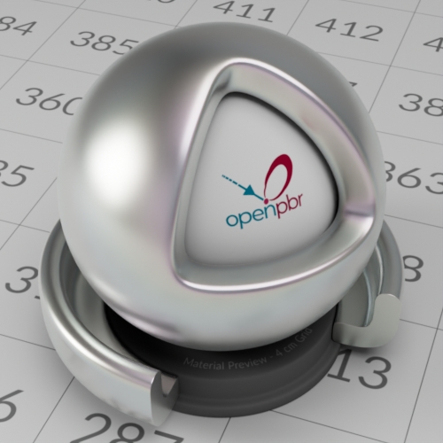

- Metalness: gold, silver, iron, car paint.

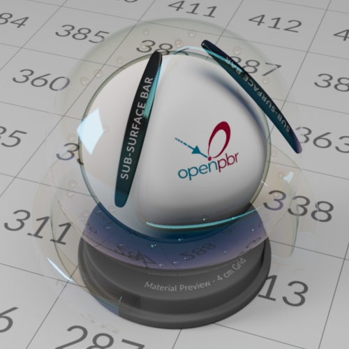

- Transmission: glass, water, honey, soap bubble.
- Subsurface: skin, marble, wax, paper, leaves.

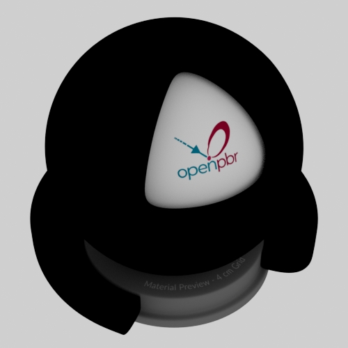

The OpenPBR Surface shader is a physically-based shader (like Standard Surface), and is thus energy conserving by default. All its layers are balanced so that the amount of light leaving the surface does not exceed the amount of incoming light.
For example, as a surface is made more specular, the diffuse layer contribution is reduced accordingly to ensure energy conservation.

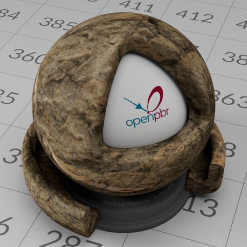

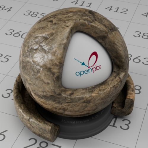

Stone rendered as glossy-diffuse surface, composed of diffuse lobe (left), specular lobe (middle), and their normalized sum. Near the specular highlight the diffuse lobe is automatically reduced since energy is conserved.

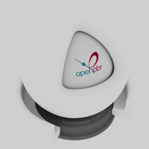

The material is also energy preserving, so that when the surface is made white, no energy is lost as the light bounces. It thus satisfies a "white furnace test" as shown below.
When using layer weights or colors with values higher than 1, energy conservation is generally broken. It is discouraged to create such materials, as they will not behave predictably under different lighting and may lead to increased noise and poor rendering performance.
