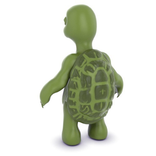

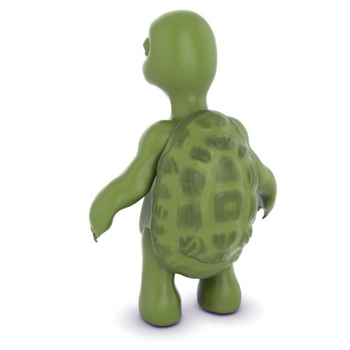

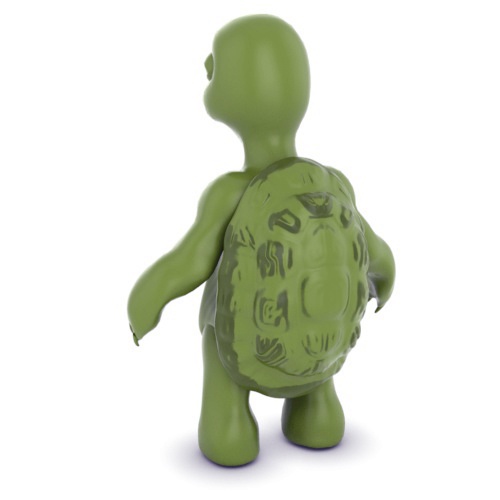

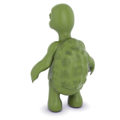

| without curvature | with curvature |
This shader will sample around the shading point within a given radius to output the curvature. You can adjust the radius, falloff, and spread of the curvature sampling as well as specify a trace set to exclude or include objects. This shader is useful for creating procedural wear or dirt maps in conjunction with a noise shader.

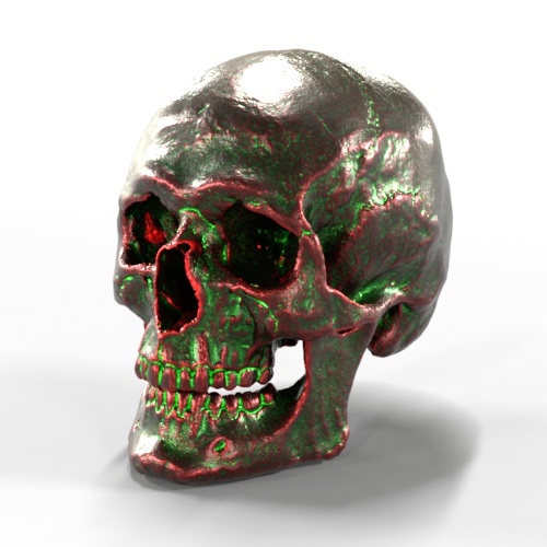

Whether to output the convex (positive) curvature or concave (negative) curvature only as grayscale, or output both with the convex curvature in the red channel and concave curvature in the green channel.

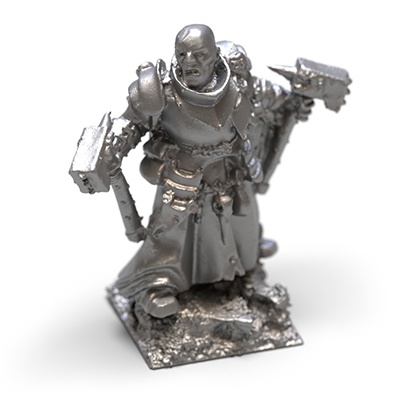

| convex (default) | concave | both |

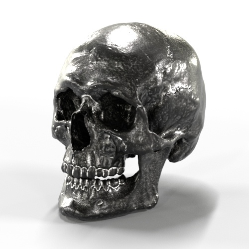

| 0.85 | 0.9 | 1(default) |

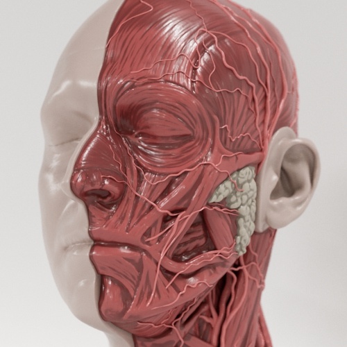

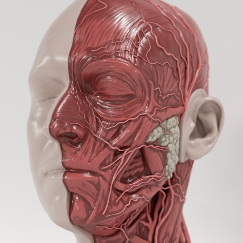

| veins included (default) | veins excluded |
