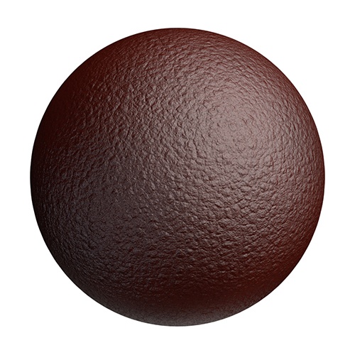

A cell noise pattern generator with options that can be used as an input to several other shader nodes to produce various effects. This is useful for creating many real-world patterns e.g., marble, granite, leather, etc.

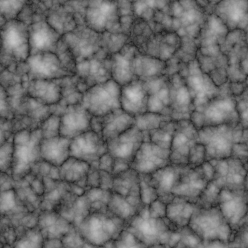

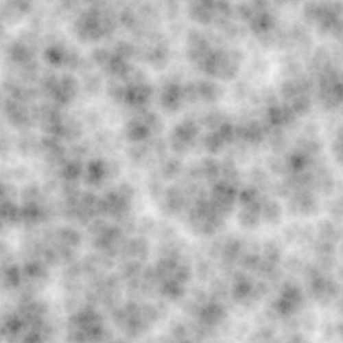

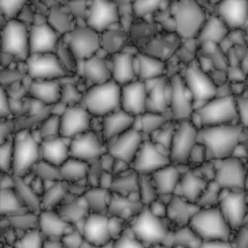

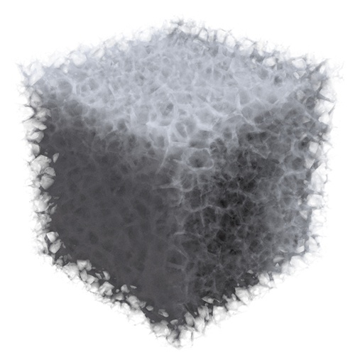

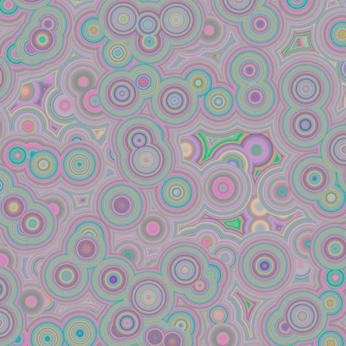

This shader provides seven patterns for now. Noise1 and Noise2 are Voronoise by Inigo Quilez with static/dynamic feature points. Cell1 and Cell2 are cell noise with static/dynamic feature points. Worley1 and Worley2 are Worley noise with the closest/second closest feature points. Alligator is another variation of Worley noise computed as the distance to the second closest feature point minus the distance to the closest feature point.

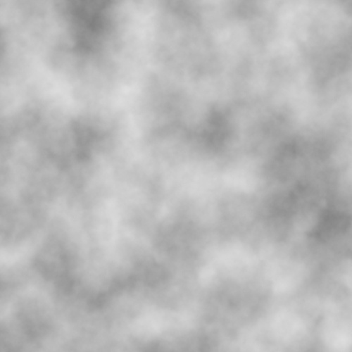

| noise1 (default) | noise2 | cell1 | cell2 | worley1 | worley2 | alligator |

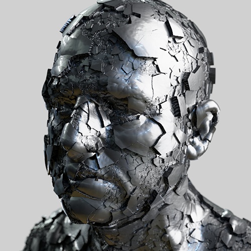

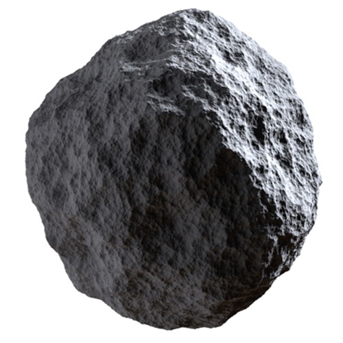

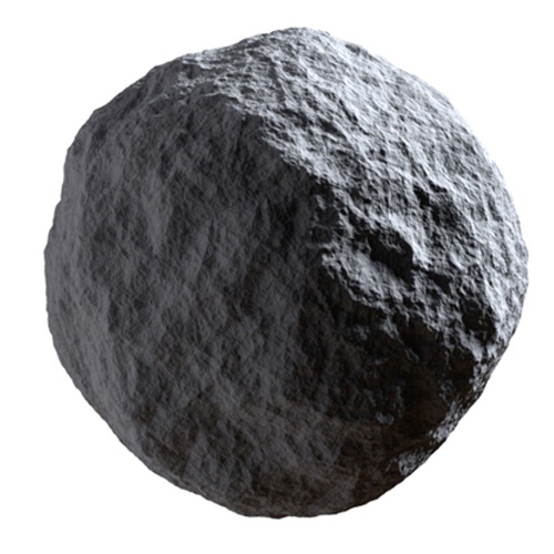

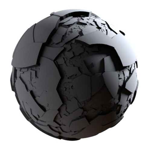

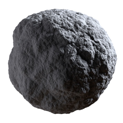

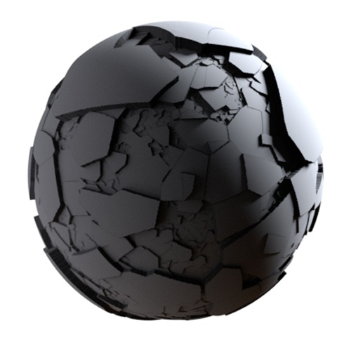

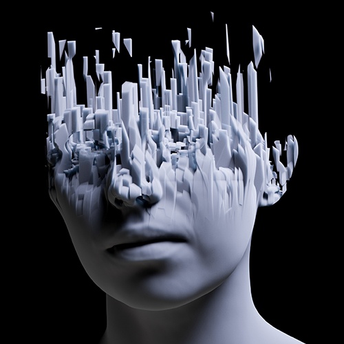

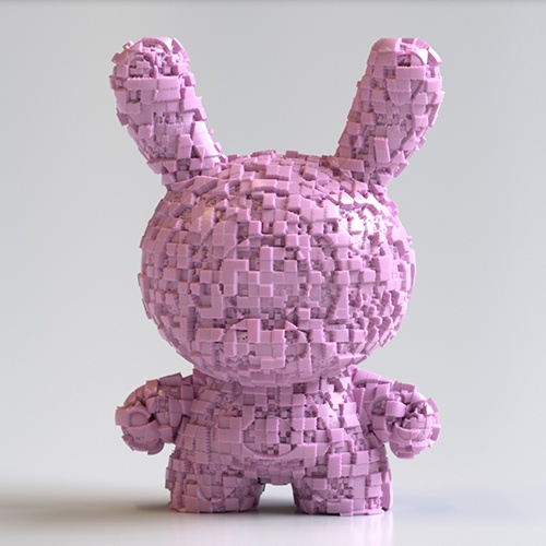

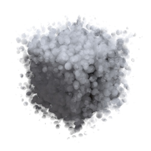

cell noise patterns -> displacement

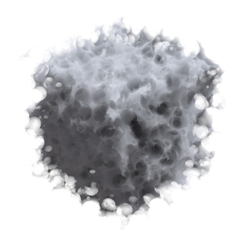

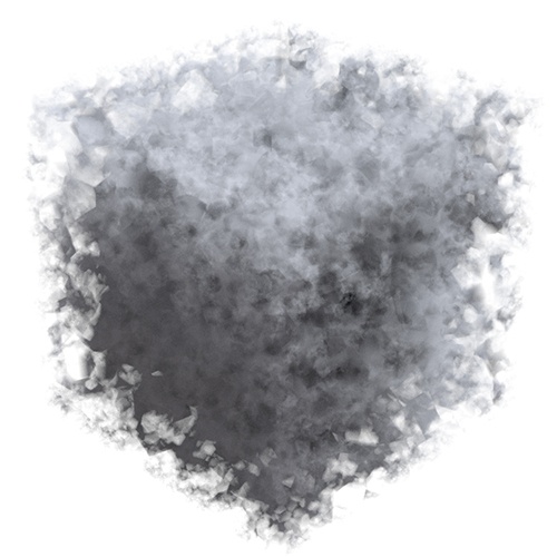

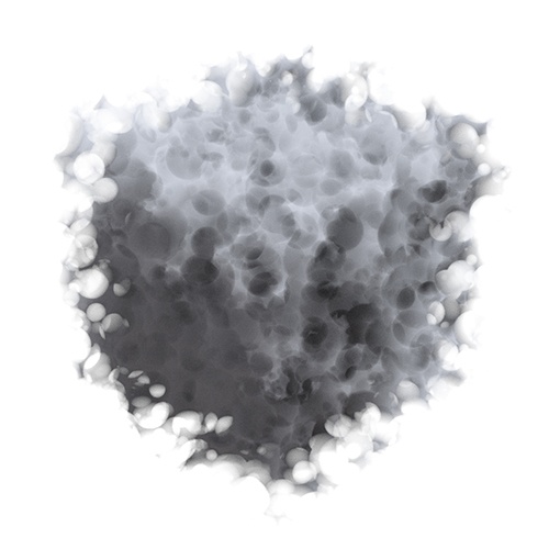

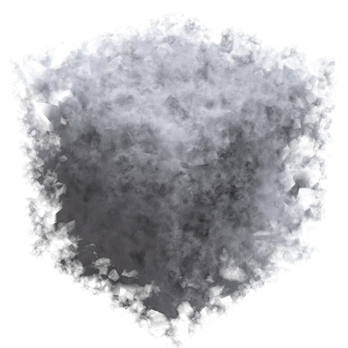

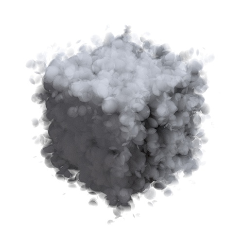

cell noise patterns -> volume displacement

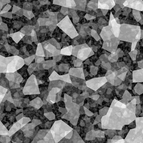

This determines how noise patterns of different octaves are merged. If Additive is enabled (default), all noise patterns are simply added. If this is disabled, the largest value is selected.

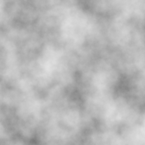

| Enabled (default) | Disabled |

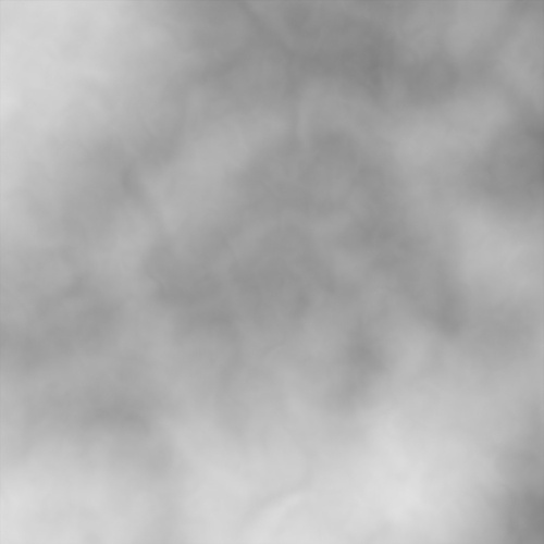

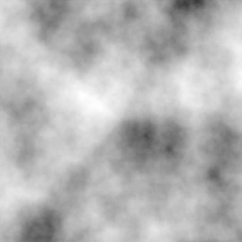

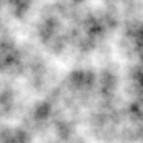

Octaves

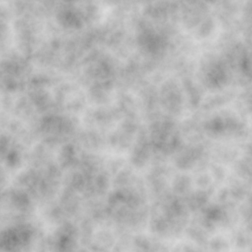

The number of octaves over which the noise function is calculated (the fractal noise function is repeated at multiple frequencies, known as octaves; normally each octave is at about twice the frequency, i.e., half the size, of the previous one, but you can alter this with the lacunarity control).
| 1 (default) | 2 | 3 |

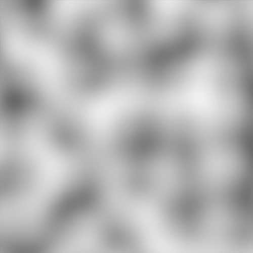

Lacunarity
Controls the average size of gaps in the texture pattern produced. Lacunarity means the change in scale between each octave - in musical scales this would be 2.0, meaning each octave is at twice the frequency/half the scale of the previous one, but for our purposes numbers that are near 2.0, but not actually 2.0 are best. In most cases, we recommend using the default value of 1.92.
| 1.92 (default) | 3 | 5 |

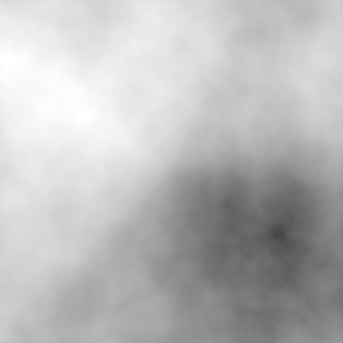

Amplitude

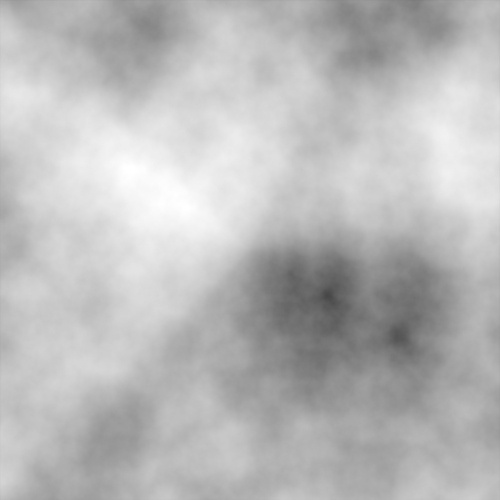

Controls the amplitude, or range, of the output. Normally, the output has values between 0 and 1; the amplitude control multiplies this.
| 0 | 0.5 | 1 (default) |

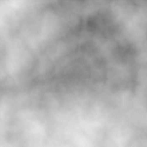

Scale
Controls the scale of the noise function in x, y, and z directions.

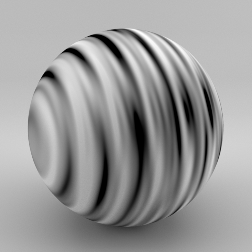

Scaling the noise in one direction only can produce interesting results.
scale x:1, y:0.1, z:0.1

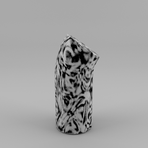

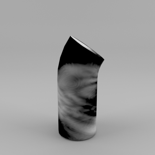

Below are animations that show Pref Space coordinates in use with a deforming object. Note how the texture sticks to the object when using Pref space coordinates, compared to Object/World space coordinates, where the texture swims.
| world/object space - texture swims | pref space - fixes texture swimming |

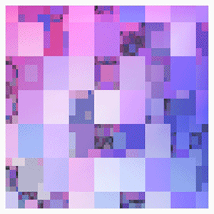

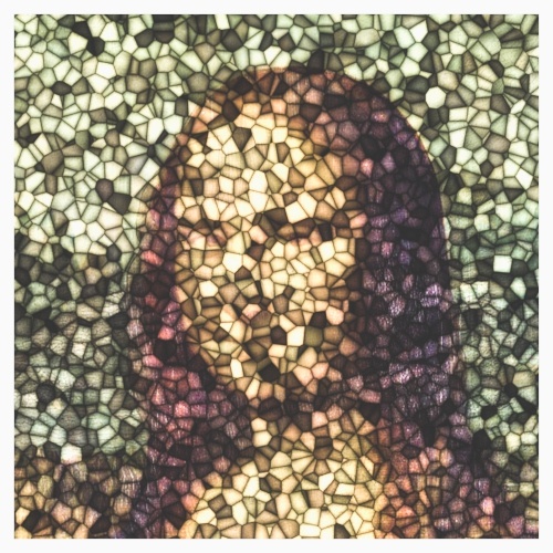

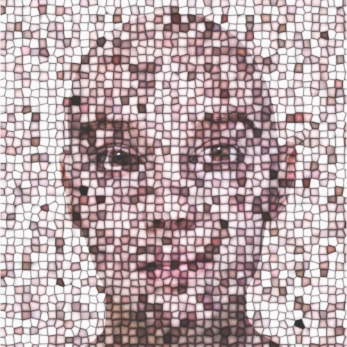

Color
Multiply a specified color to the resulting noise pattern.

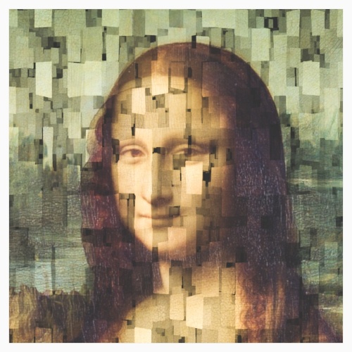

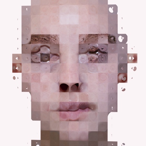

| image -> color | image -> color + pallete |

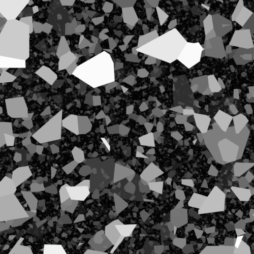

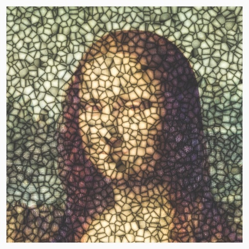

Palette

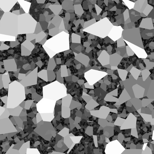

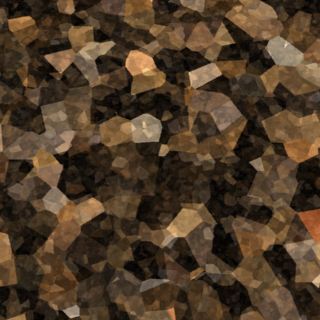

The color of each Voronoi cell is randomly picked from the connected node. An arbitrary RGB node, including image and ramp, can be connected here. Note that this is different from simple texturing using UV.

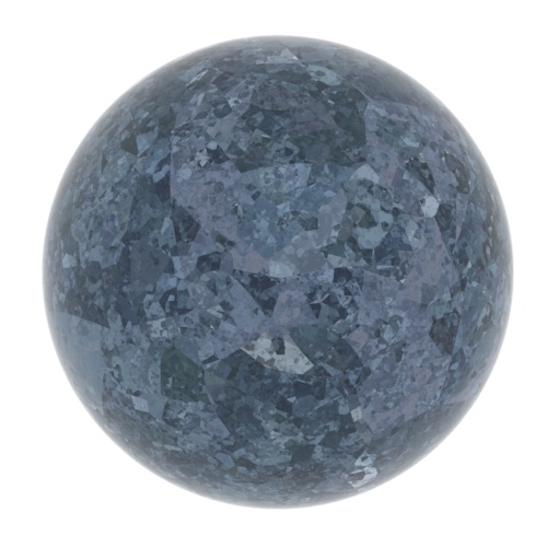

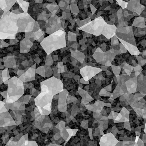

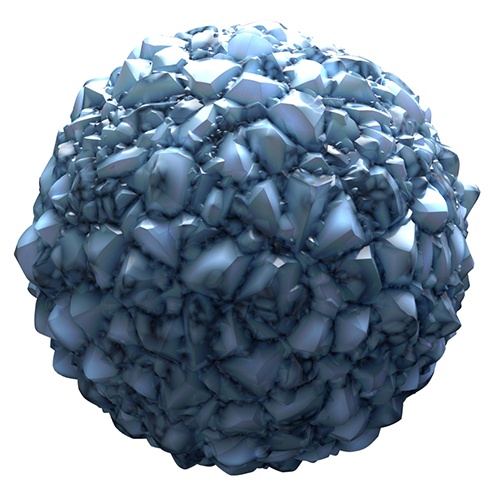

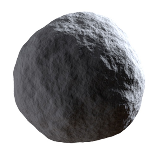

Stone and flake type textures achieved using palette (with density)
Density

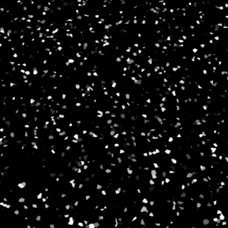

This parameter can be used to create flake noise by decimating some cells. This only works with Cell1/Cell2 for now.
| 0.25 | 0.5 (default) | 0.75 |

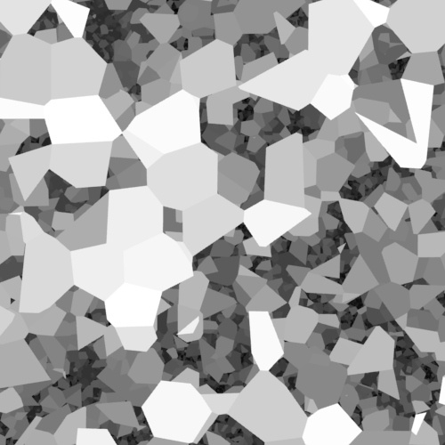

Randomness
If randomness is greater than 0, feature point locations are jittered. If the value gets closer to 0, patterns have a more regular, axis-aligned look.
| Noise. Randomness: 0 | Noise. Randomness: 1 | Noise. Randomness: 0 | Noise. Randomness: 1 |
| Cell. Randomness: 0 | Cell. Randomness: 1 | Worley. Randomness: 0 (static). | Worley. Randomness: 1 |
