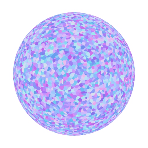

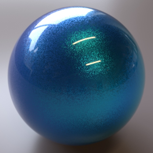

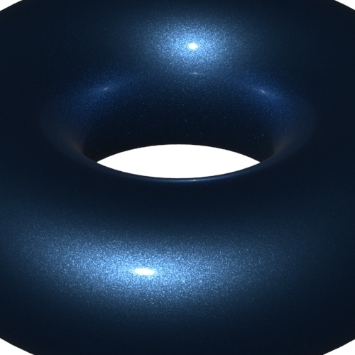

This shader creates a procedural flake normal map that can be used for materials such as car paint.
Note that the map does not perform any filtering, so small flakes require more Camera (AA) samples to become clean. When connected to a Normal Map shader use Tangent as the Output Space on flakes, Tangent as the input space (Mode) on the Normal Map shader, and disable Interpret 8/16 bit normal map as linear. A typical workflow would be to connect Flakes to Standard Surface Normal Camera. You can also connect the mask (alpha channel) of the Flakes shader to a Mix Shader to drive different colors for the flakes. For example, you could make the flakes metallic and the other parts glass by mixing them together using a Mix Shader.
When rendering an animation using Flakes, you should enable motion blur (to avoid temporal flickering).

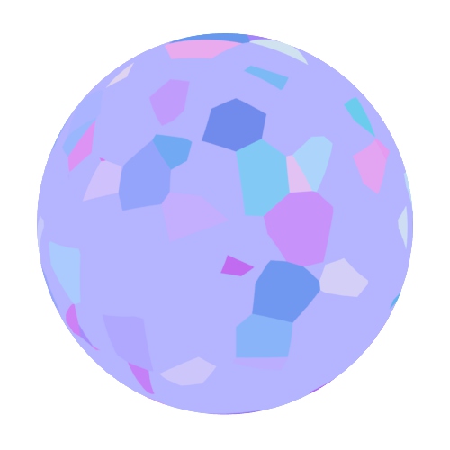

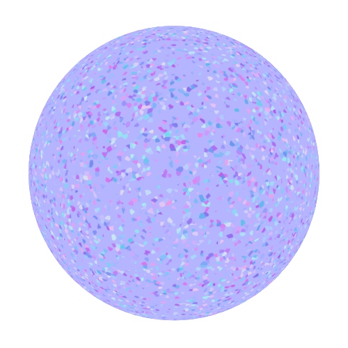

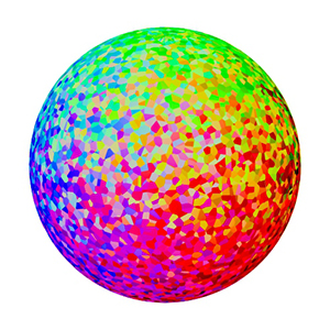

Scale
Scales the flake structure up or down. Smaller values zoom out of the map, giving a larger number of flakes.
| 0.1 (default) | 0.05 | 0.01 |

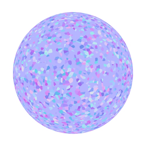

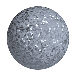

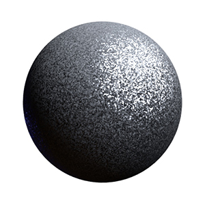

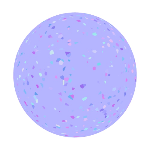

Density
Controls the density of flakes. There will be no flakes if it is 0. The surface is fully covered with flakes at 1.
| 0.1 | 0.5 (default) | 1 |
You can use the Mix Shader to mix multiple Flakes shaders together with different Density and Normal Randomize values.

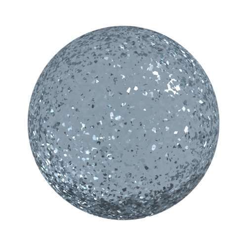

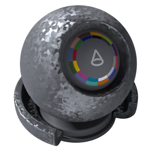

3d Flakes
The following attributes should be used to control 3d flakes only.
3d flakes will not render correctly if the camera is positioned inside a polymesh.

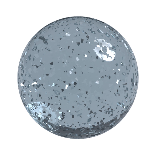

Step
This shader performs ray marching to compute 3d flakes. With this users can specify the Step Size. The number of layers is determined by depth/step.
When rendering flakes that are close to the camera, you should use a smaller Step Size so as not to miss any flakes. 3d flakes will not render correctly if the camera is positioned inside a polymesh.
Decreasing this value may increase render times dramatically.
| 0.1 | 0.5 |

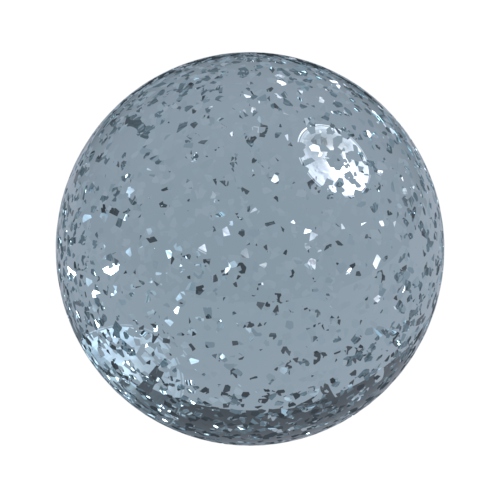

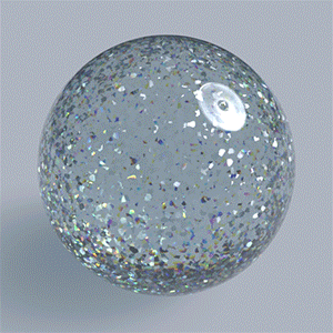

Depth

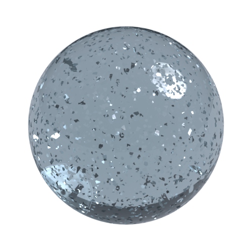

Specifies how deep a ray goes inside of an object. This shader generates 2d flakes if Depth = 0, and 3d flakes otherwise. If a ray hits an object, it cannot traverse longer than the specified Depth.
| 0 = 2d flakes (default) | 1 = 3d flakes |
| 0 (2d flakes) | 1 (3d flakes) |

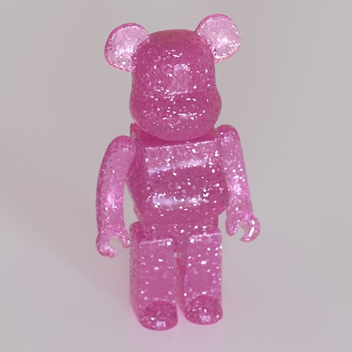

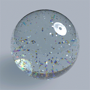

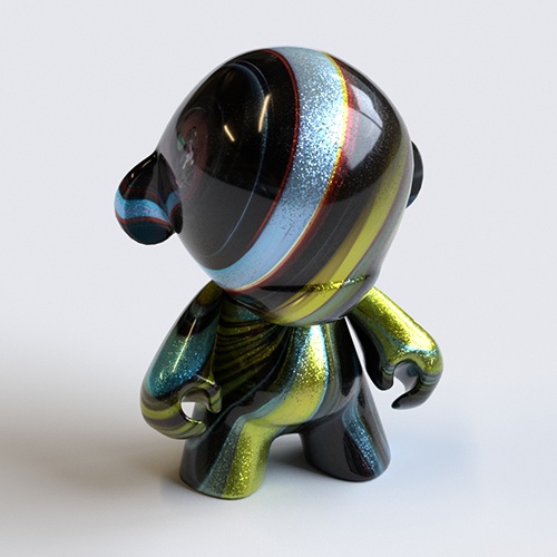

IOR

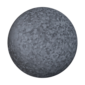

This value is used to refract a ray used for raymarching. This would be useful to give a 'fake' transparency effect (thus avoiding having to use true transparency which can add to render times). In some situations, it is not necessary to make the surface shader transparent. An example would be a material such as Goldstone (IOR 1.53) which has 3d flakes in it but they don't really look transparent.
| 1 | 2.4 |

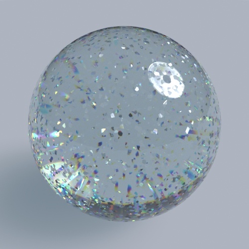

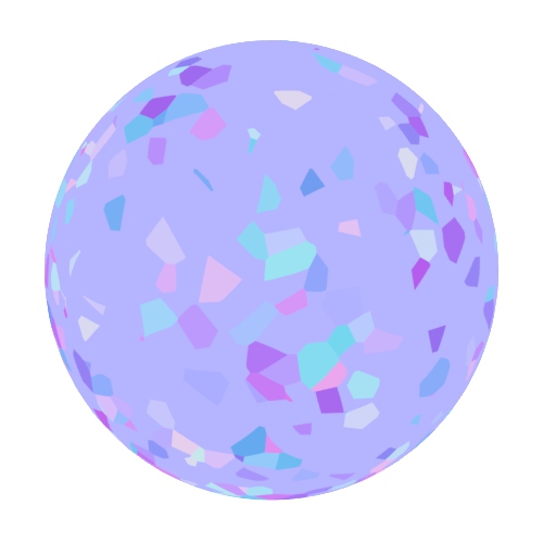

Normal Randomize
Blends between the smooth surface normal (0) and the random flake normal (1).
| 0.1 | 0.3 | 0.6 |
