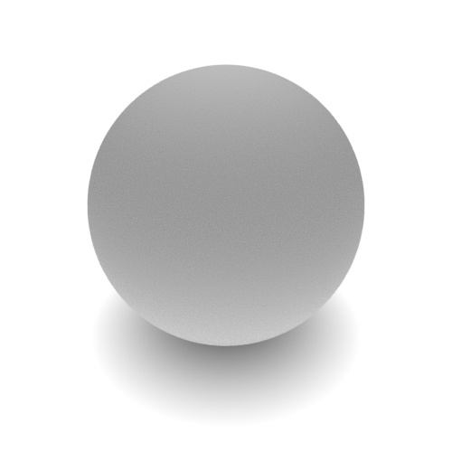

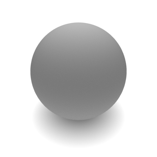

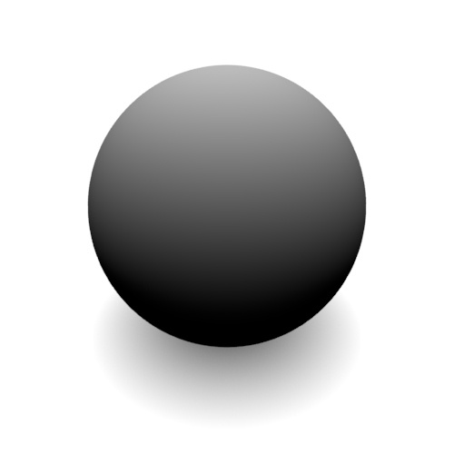

Indirect Diffuse
The amount of diffuse light received from indirect sources only.
| 0 | 0.5 | 1 (default) |
Indirect Diffuse: 0 (default) creates a more two-dimensional looking Toon shading effect.

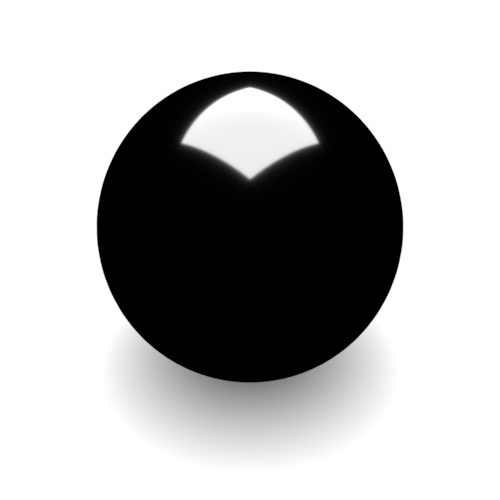

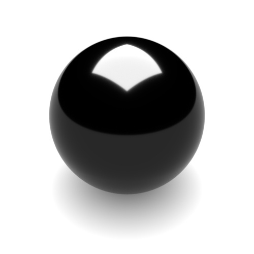

Indirect Specular
The amount of specularity received from indirect sources only. Values other than 1.0 will cause the materials to not preserve energy, and global illumination may not converge.
