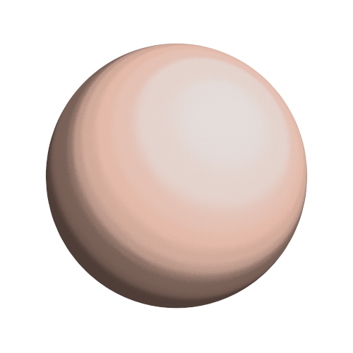

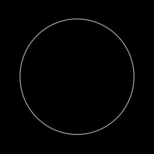

Rendering Edges Separately
To save the beauty render (without edges) and edges separately, you must create an RGBA AOV (beauty) and a Custom AOV (edges). Use a Box Filter for the RGBA AOV (because the Contour Filter uses Box Filter internally) and a Contour Filter for the edges Custom AOV. This enables you to render two separate images simultaneously, which also saves the overall rendering time.
| RGBA AOV without edges (Box Filter) | Edges Custom AOV (alpha channel) using Contour Filter |
