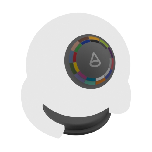

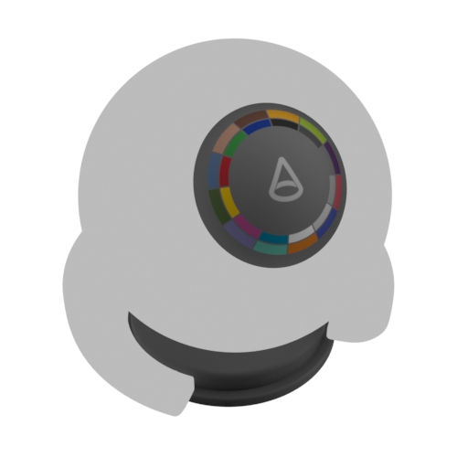

| 0 (default) | 0.5 | 0.8 |

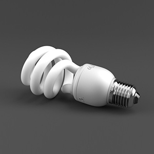

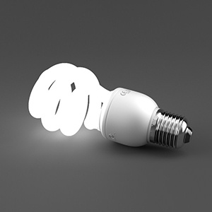

Bulb with emissive shader assigned to it

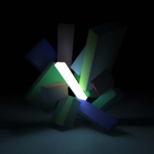

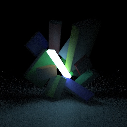

| Diffuse samples: 2 | Diffuse samples: 6 |

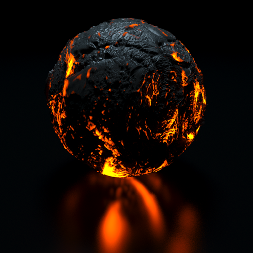

Texture map representing hot lava connected to Emission Color
