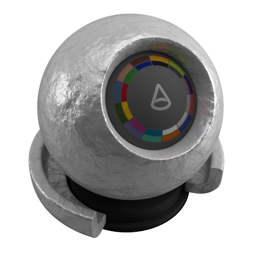

Bump Mapping
The bump mapping attribute accepts a shader that perturbs the normal for bump mapping.
When adding bump to the edge, you should also change the Edge Detection to Shading Normal.
Bump Mapping Mode
Choose the component(s) affected by bump: Diffuse, Specular, or Both.
| Both (default) | Diffuse | Specular |
