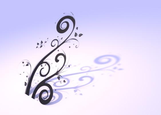

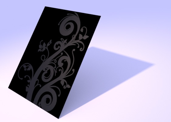

If you leave the Index of Refraction (IOR) at 1.0, both methods can give similar results; however, opacity renders faster, for sprites. Opacity will also cut out the shape completely, whereas transmission will leave the reflections/speculars visible even on areas that are completely transparent. Here are two images that show the difference when rendering sprites:
| Leaf mask -> opacity (correct) | Leaf mask -> transmission (incorrect) |

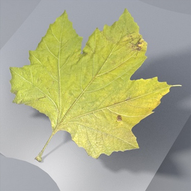

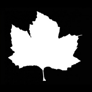

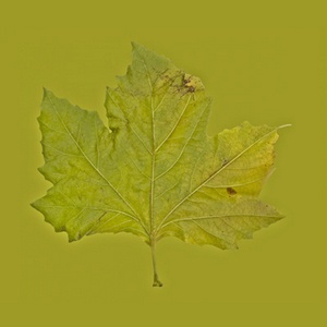

This is the texture and mask used for the leaf:
| Leaf texture map | Leaf alpha map |
Note how when using transmission, the specular/reflections are still visible in the transparent areas. You can, of course, drive the specular weight using the same mask to fix the problem, but using transmission for this purpose is simply wrong.

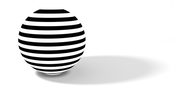

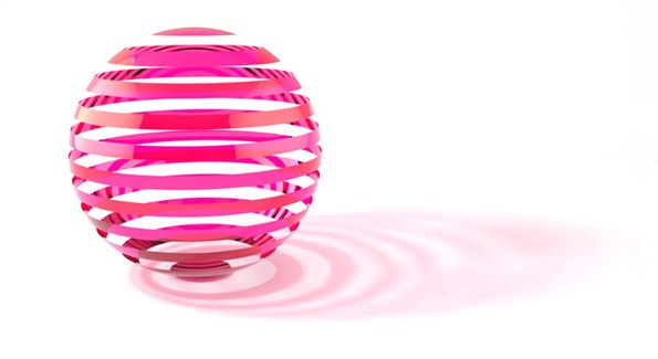

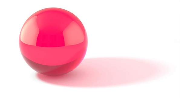

As explained earlier, it's usually best not to use transmission and opacity together in the same shader, as it would cause unnecessary slowdowns in the render; however, there are a few situations where combining them can be useful. Below are some examples of a simple glass sphere being cut out using a stripe mask:
| transmission only | Mask texture | Mask -> opacity |

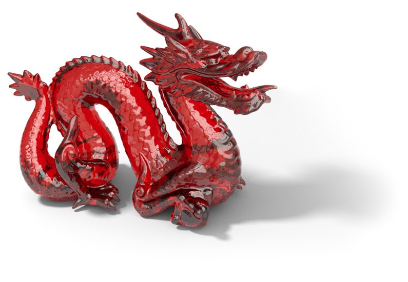

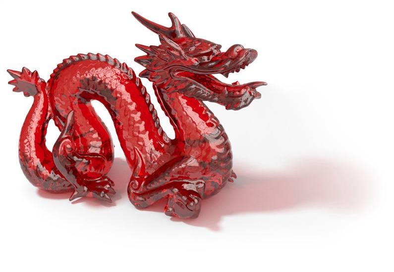

In the following scene, you can see the Stanford dragon rendered with opaque enabled and disabled. Note that opacity is not used at all in this example:
| opaque: on | opaque: off |

- When using opacity for sprites, make sure that your mask is pure black and white, for example in the black areas there shouldn't be any noise or other imperfections as that will have a negative effect on the render times, in other words, it's not a good idea to use JPEG textures for masks as they often have compression artifacts.
