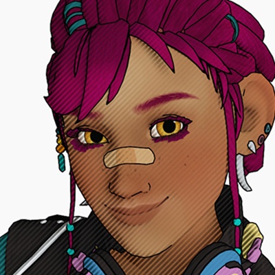

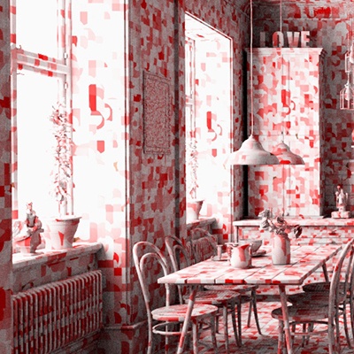

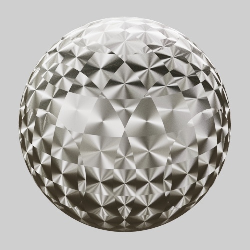

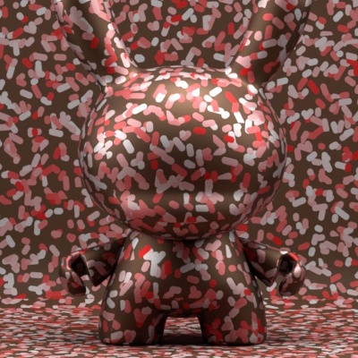

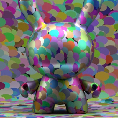

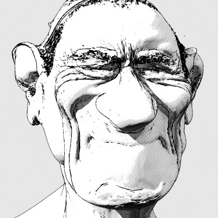

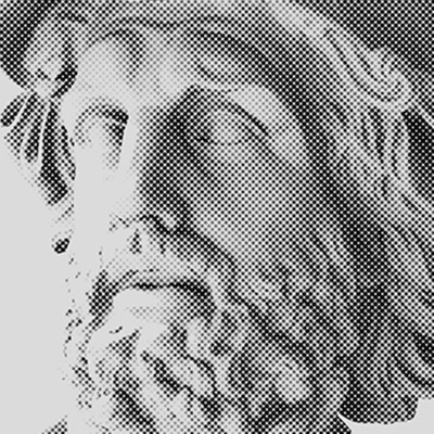

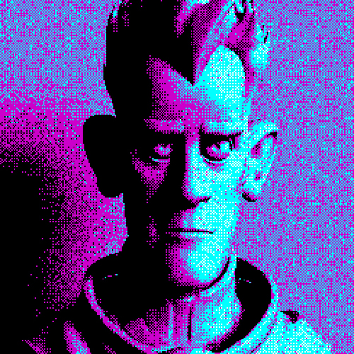

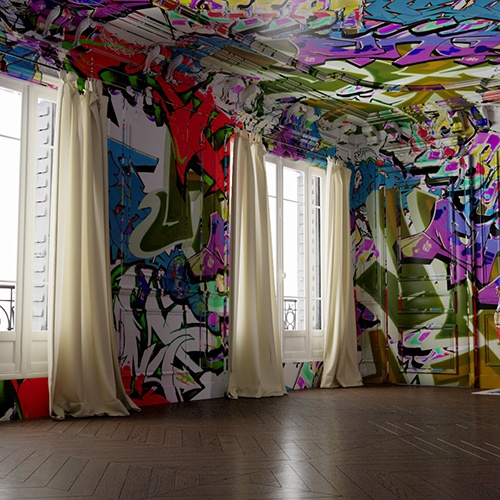

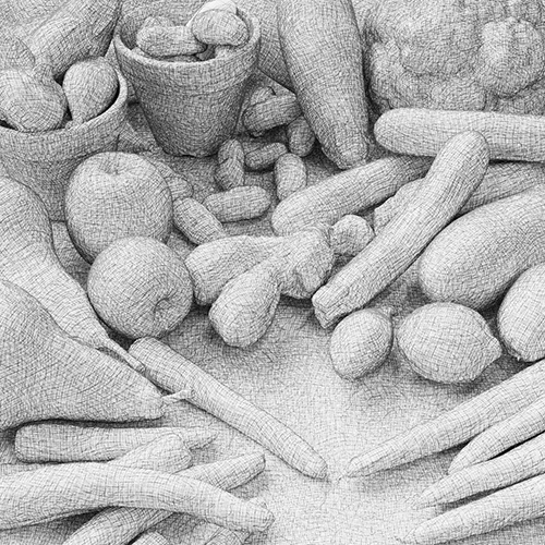

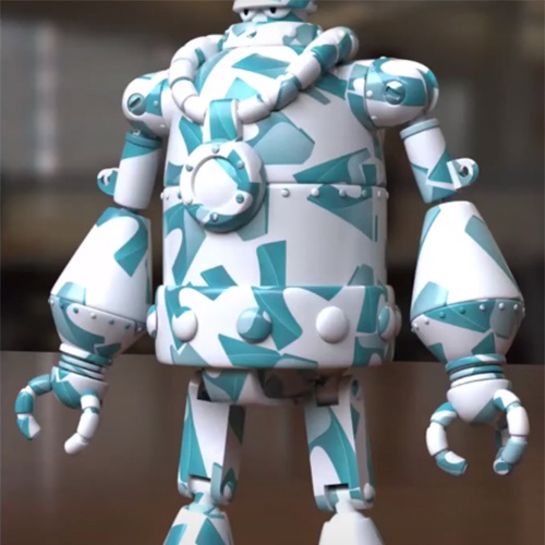

The OSL shaders used in the above examples can be found here.
