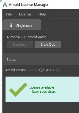

  1. Open the Arnold License Manager (in the Arnold menu for your Arnold plugin, click Licensing > Arnold License Manager)
  2. If you don't see a Single-user tab, click License > Switch to Single-user Licensing
  3. If prompted, install single-user licensing and register Arnold.
    (Note : You will require administrator privileges to install the licensing service and register Arnold)
  4. Click Sign In and enter your Autodesk ID and password.
  5. You'll see the status of your single-user license. Happy rendering!
