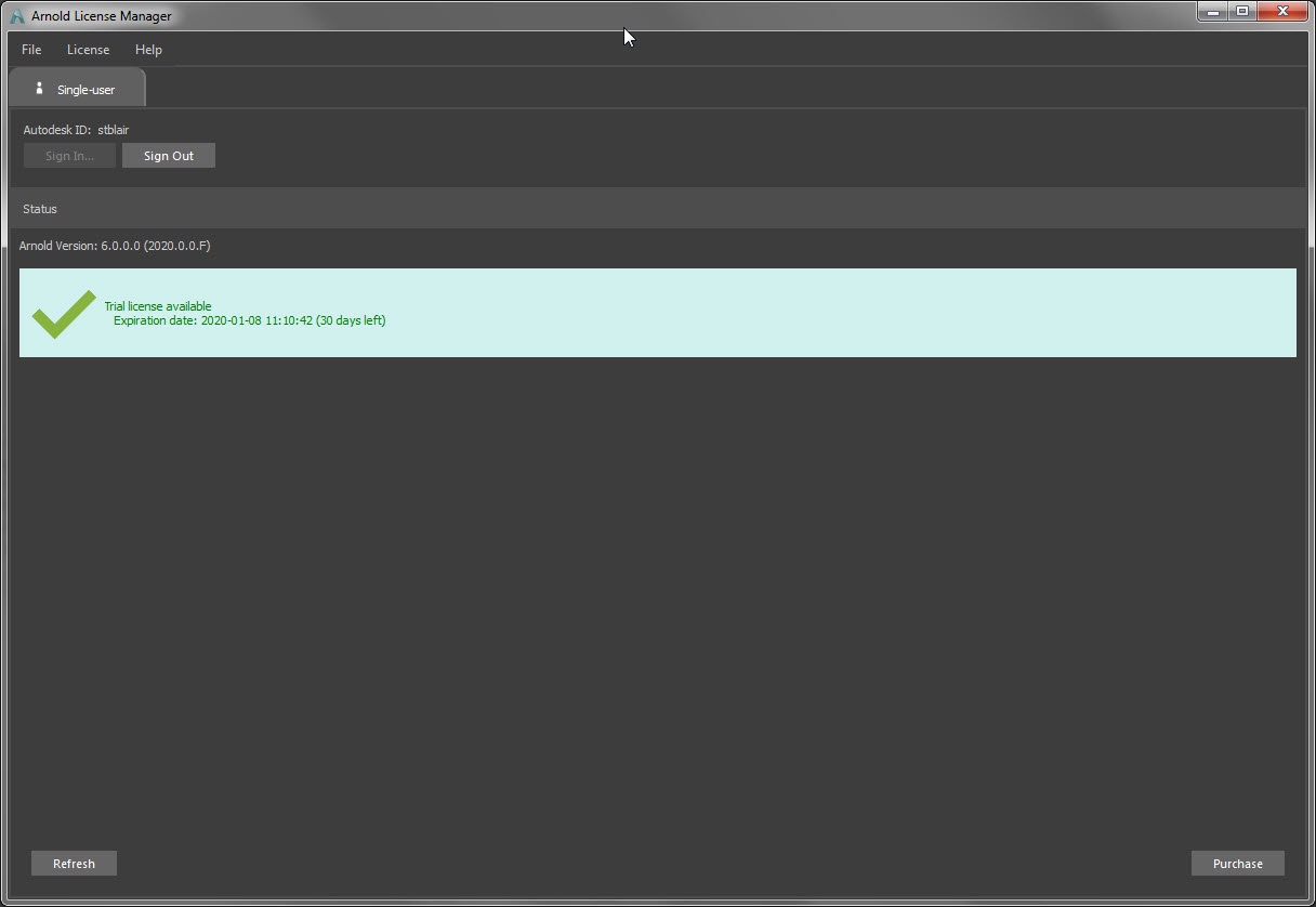

Open the Arnold License Manager (in the Arnold menu for your Arnold plugin, click Licensing > Arnold License Manager)
If you don't see a Single-user tab, click License > Switch to Single-user Licensing
If prompted, install single-user licensing and register Arnold.
Click Sign In and enter your Autodesk ID and password.
You'll see the status of your trial license. Happy rendering!
