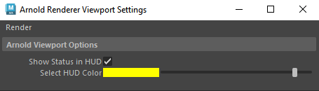

It is possible to render inside the Maya viewport, by switching the viewport "Renderer" to Arnold. Some of the Arnold RenderView options are exposed in the viewport as follows:
  1. Start/stop Arnold in the viewport.
  2. Define a crop window.
  3. Set the viewport render resolution.
  4. Set shading to debug mode.
  5. Select display channels (AOVs).
