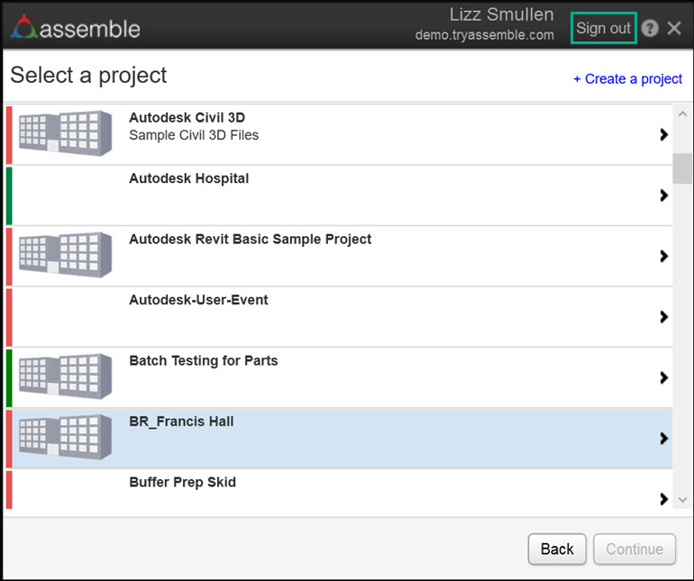

      Autodesk Assemble opens to the Select a project page.
      Note: If you want to cancel the change server configuration process so that you may keep using the current one, select Sign Out in the top, right corner of any dialog.
