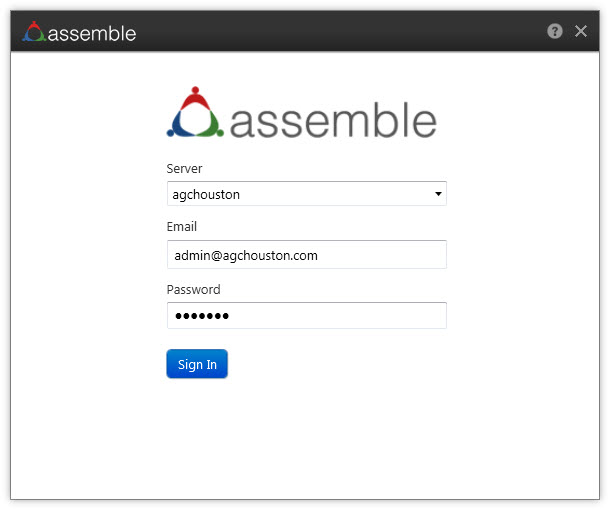

  1. Verify the fields in the Configure Connections window.
    • Assemble Server: Enter the tryassemble.com prefix that represents your company's site. For example, if your Assemble site address is agchouston.tryassemble.com, you would enter agchouston for the server name.
    • If you receive the error message "Could not establish trust relationship for the SSL/TLS secure channel with authority 'api-your assemble site address**" try adjusting the server name to read https://api-*your assemble site address. For example, the Houston branch of The Associated General Contractors of America would enter *https://api-agchouston.tryassemble.com**.
    • Email: Enter the email address you use to log in to Assemble.
    • Password: Enter the password you use to log in to Assemble.

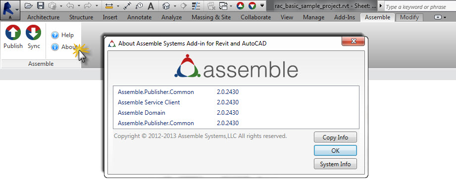

  3. Verify that the version number of the Assemble Add-in works with the version of Assemble you are using. For example, Add-in version 2.0.2430 works with Assemble web version 2.0.2430.
    • Select the Assemble tab from within your Autodesk application.
    • Click the "About" button to obtain the version info for the Add-in.
    • In the Assemble web application, click the About button from the drop-down gear icon in the top-right corner of the Project Dashboard
