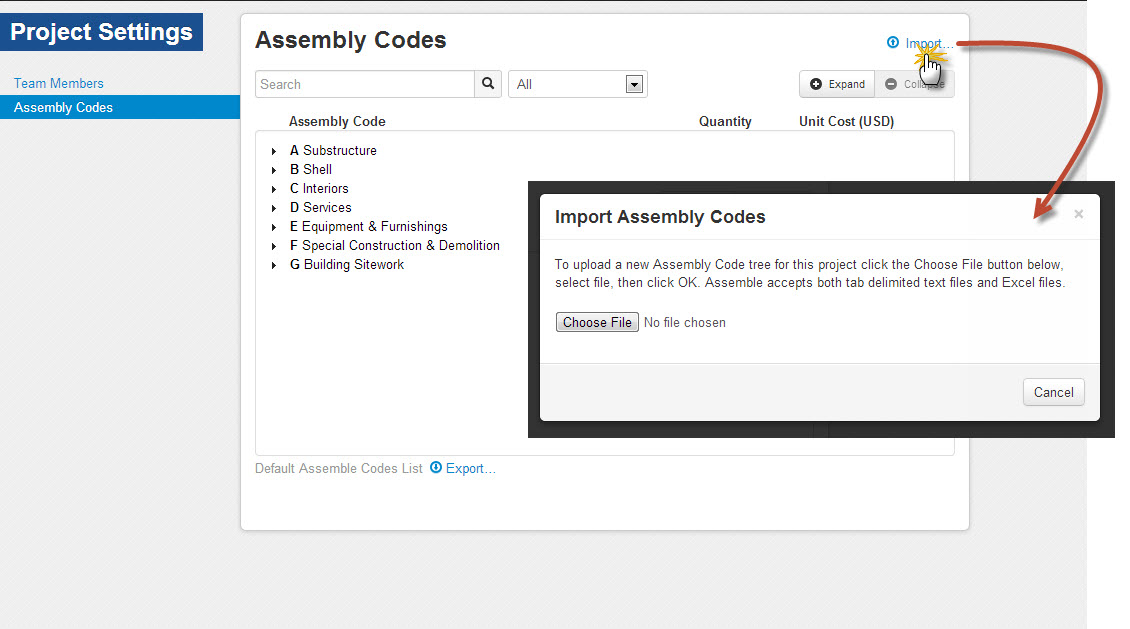

Assembly Code Tree Setup
Before an automated estimation can be performed, the Assembly Code Tree file needs to be updated so that each assembly code has an associated quantity value and unit cost. Once a tree file has been conditioned with the desired values, a Project Administrator can access the Project Settings pane and import the revised document into the respective project(s) within Assemble.
Your custom assembly code file will need the following column headers:

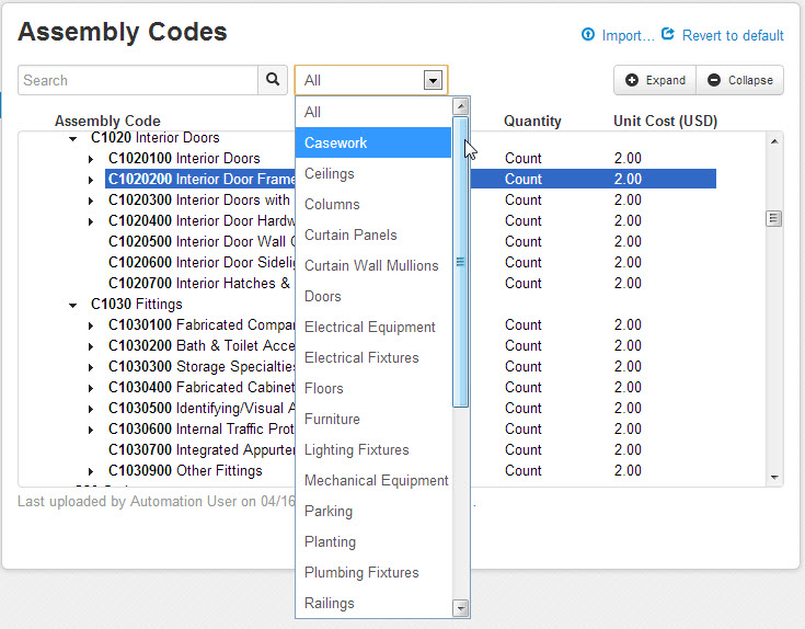

Assembly Code Tree Display
Following a tree file import, Project Administrators can view a graphical representation of the assembly code tree in the Project Settings pane. If the imported file contains any category references, the category drop down control will be present and will contain options for the included categories. Otherwise, the control will not appear. If the imported file contains quantities and cost information, that information will appear in the tree interface next to the associated assembly codes.

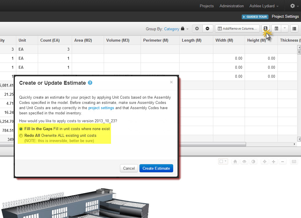

To automatically apply unit costs to assigned assembly codes
  1. Open a suitable model so the grid of data is visible.
  2. To the right of the Add/Remove Columns button is the Create or Update Estimate control which displays a “$” symbol.
  3. Click the $ button will expose the controls for the automated estimation feature. There are two options available to the user:
    • Fill in the Gaps: Fill in unit costs where none exist
    • Redo All: Overwrite ALL existing unit costs
  4. After an option has been selected, click the Create Estimate button clicked and the grid will be updated with the information from the assembly code tree.
