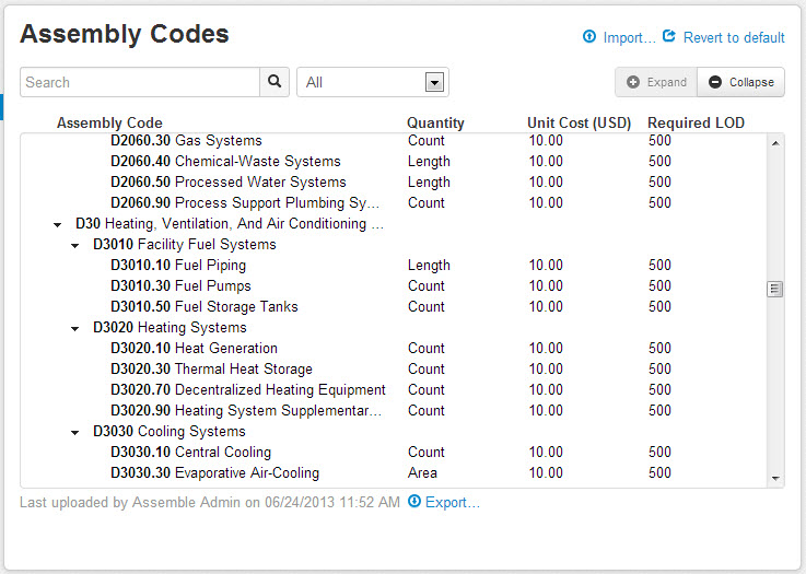

Step 3: Import Your Custom Assembly Code Tree into Assemble
Navigate to the Project Settings for your project and import your custom file. After importing, you will see your custom assembly codes and any unit cost and/or required level of development assigned to the codes.

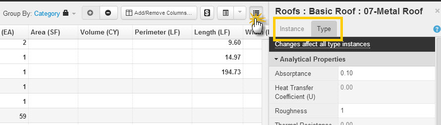

Step 4: Manage Data in the Assemble Grid
Begin by selecting the element or group of elements to edit under your grouping levels. All editable parameters will be available in the Properties pane. Notice that the Assembly Code field allows you to pick a new code from your custom assembly code tree. Assign your custom codes to all relevant elements in the Grid. Additionally, now would be a good time to edit the other parameters that will later be synced back to the Revit model. Did you create custom parameters? Can they be utilized to make the model information more efficient?
For more information on Working with the Properties Manager.

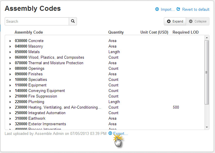

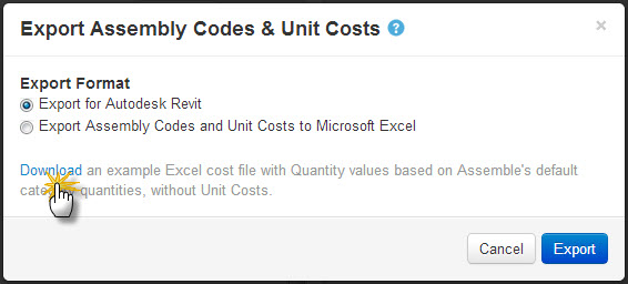

Step 6: Import Your Custom Assembly Code Tree into Revit
Navigate to the Assembly Codes pane of Project Settings and Export your custom assembly code tree into a file for import into Revit. Import your custom file into the back-end of Revit as the UniformatClassifications file. This allows Revit to match your custom codes with your custom assembly descriptions.
