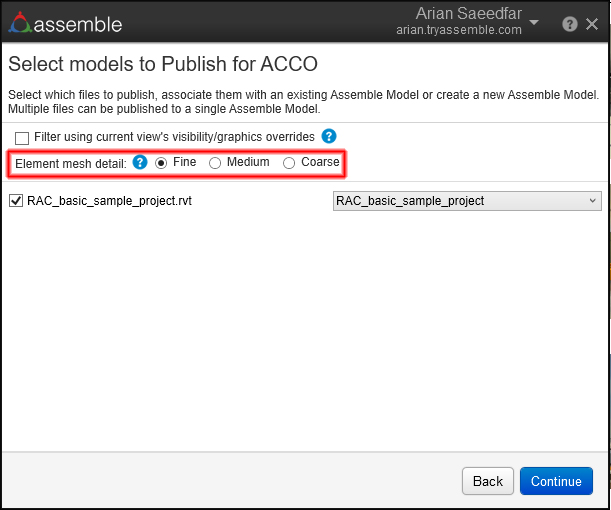

When publishing models to Assemble, you have the option to choose the mesh detail level of elements in the Assemble 3D viewer.
When the geometry of a model is complicated, it might take a long time to publish a model. This feature allows the users to adjust the mesh detail level. You can choose from one of the options below:
Fine: Produces the maximum mesh quality to get the most accurate and best geometry result.
Medium: Produces the optimum mesh quality to reduce publishing time and reduce mesh quality.
Coarse: Produce the minimum mesh quality to get the fastest publishing time result.
