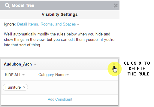

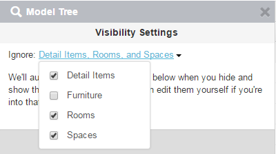

However, to make your furniture visible, simply click on Visibility Settings, and then click the drop-down for ignored categories. De-select the Furniture check box and Update the Visibility Settings. Finally, modify or delete the new rule created, and Update once more.
