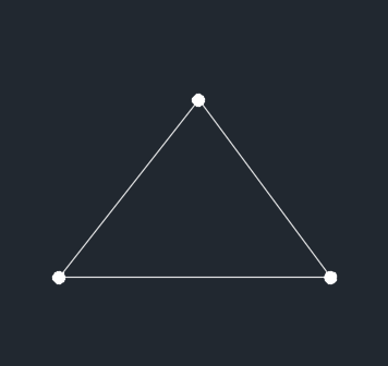

For better understanding, the image below is one instance of an object with 3 vertices.

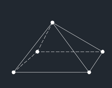

The next image is an example of one instance of an object with 5 vertices.
