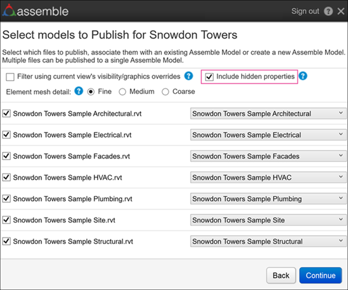

Utilizing the Include Hidden Properties Option when Publishing to Assemble
When publishing models to Assemble, you can include hidden properties from the Revit model.
Some models, like many fabrication models, can contain hundreds or even thousands of extra hidden properties in Revit. When a model contains many hidden properties, it might take a long time to publish and can create unmanageable lists of properties in Assemble. This feature allows you to adjust the properties.
You can choose from one of two options:
Checked: Hidden properties are brought into Assemble along with visible properties (default setting). By default, this option is checked. If a member unchecks it, it remains unchecked.
Unchecked: Hidden properties in Revit are ignored and only visible properties are brought into your Assemble model.
