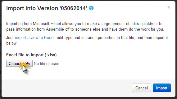

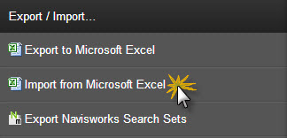

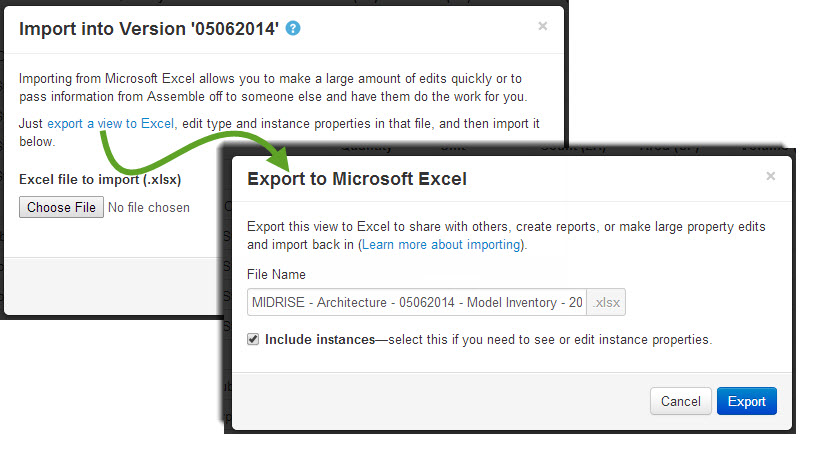

From the left panel, under Export / Import, select Import from Microsoft Excel.

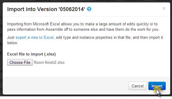

Click Choose File to locate and upload the Excel file you wish to import. Please note that your file must adhere to the import acceptances and constraints listed above.
- The hyperlink to export a view to Excel will open the Export dialogue window. Please note that if you want to import changes made to instance properties, the Include Instancescheck box needs to be checked.
After uploading your Excel file, click Import. You will have a chance to review what will be imported prior to accepting the changes.

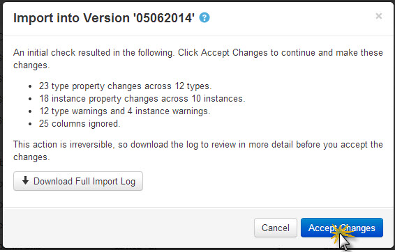

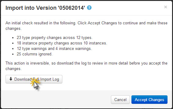

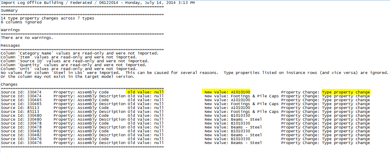

The Initial Check dialogue window will provide you with a summary of changes, or will notify you that there is nothing to change. To see the individual call-out of changes, click the Download Full Import Log button prior to accepting the changes. Please note that once changes are accepted, this cannot be undone.
The Import Log will list the instance and/or type changes, any warnings regarding making the acceptance, and/or messages regarding ignored columns.
When you are ready to commit to the changes, click the Accept button. Otherwise, discard the import by clicking the Cancel button.

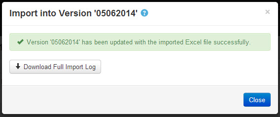

After accepting the changes, you will be notified when the import is successful. Again, you have an opportunity to view the committed changes by clicking the Download Full Import Log button. Click Close to return to your work in Assemble.

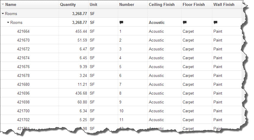

The Assemble Grid will be refreshed to show your imported data
