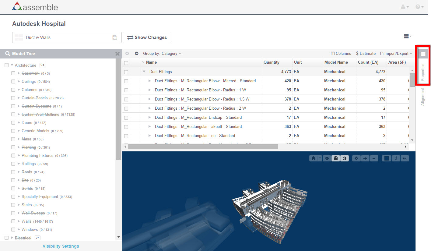

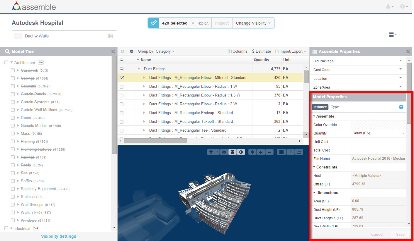

To edit the model data, click the Properties tab or icon, or simply click on a line item in your model inventory. Modify type and instance parameters as necessary, and then click Save.
Model Properties Constraints
Fields that are grayed-out cannot be edited within Assemble.
Unit Cost, Total Cost, Quantity (source), and Color Override fields are Assemble proprietary fields that can be edited for all instances and cannot be synced back to Revit.

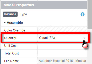

Unit Cost and Total Cost are available for editing when multiple instances are selected when the source quantity specified is the same for all instances, and not when Quantity is
Note: The Source Quantity can be changed by selecting an option under the Quantity field on the Instance tab.
