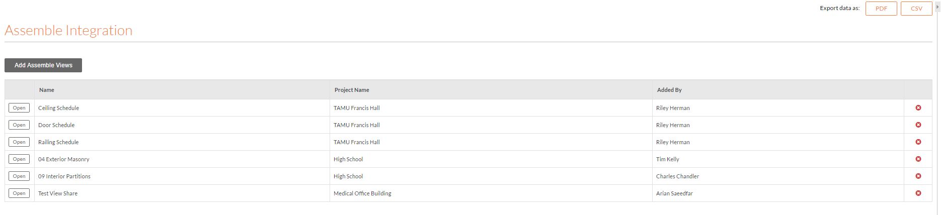

In Procore, locate your project and select the Assemble tab. Click on Add Assemble Views to add your saved views from Assemble.
Select the project in Assemble to correspond with your Procore project. Note that only the projects containing shared views will be listed, and each project will list only the views that have been tagged to share in Procore.
Select the view or views that you would like to include as a Procore Project Document, and click Add.
