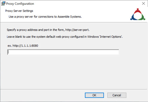

  6. Select Set Proxy.
    The Proxy Configuration dialog appears.
  7. Do one of the following:
    • Enter a proxy address and port. For example, http://server:port.
    • Leave this box blank to use the system default web proxy.
  8. Click OK.

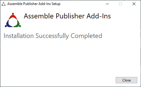

  11. Click Finish to close the setup wizard.
    The following message appears:
  12. Click Close
    An Assemble tab is added to the design tool menu bar.
